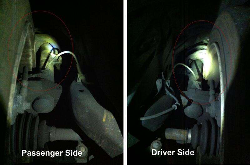

Here's a picture comparing the clearances on both sides. I'll take the wheel off later today and get some pics inside the driver's wheel well.

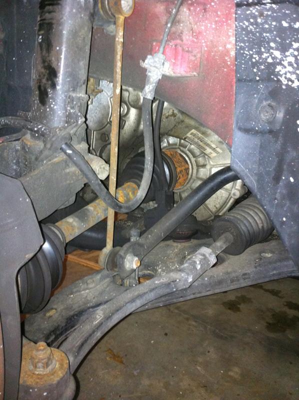

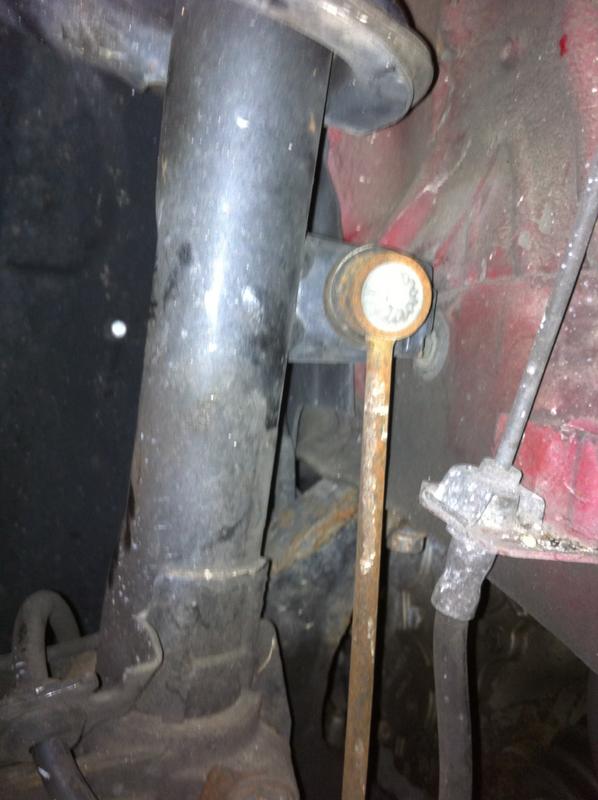

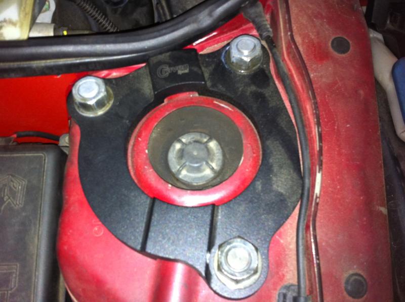

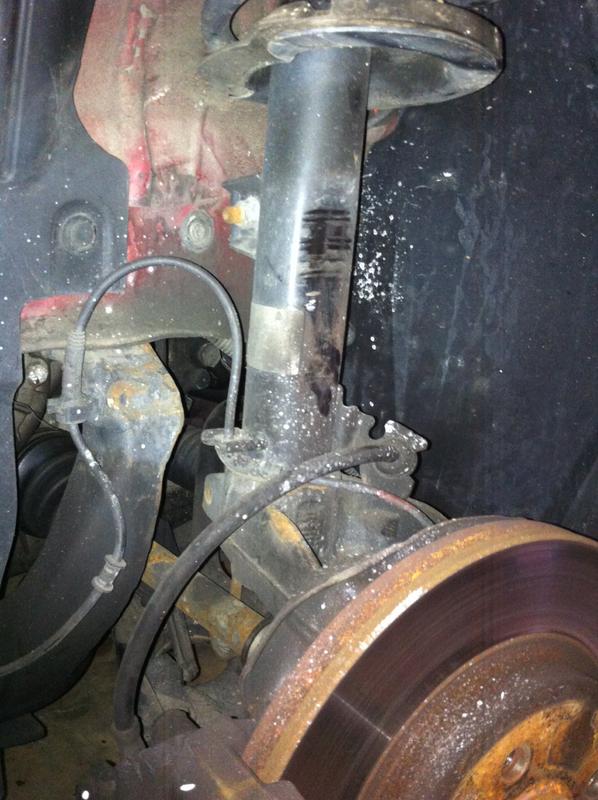

Here are some pics I took inside the wheel well from various angles. Nothing looks obviously bent to me, but I'm not sure exactly what I'm looking for. There are marks on the strut from where the rim/tire rubbed, and the strut has a small dent in it below where the marks are.
One other possible clue I found is a receipt where the previous owner had the driver's side driveshaft replaced in 2012.
Attached Thumbnails Alignment Advice-photo-oct-19-4-48-53-pm.jpg   Alignment Advice-photo-oct-19-4-49-07-pm.jpg   Alignment Advice-photo-oct-19-4-49-19-pm.jpg

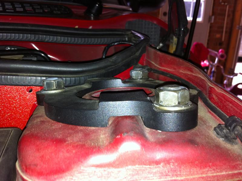

Last two pics of the strut reinforcement on the driver's side.
Attached Thumbnails Alignment Advice-photo-oct-19-4-53-13-pm.jpg   Alignment Advice-photo-oct-19-4-53-41-pm.jpg

You have a print out?
The inside top of the left front tire/rim was nearly rubbing against the strut, compared to the right front where the clearance between the tire/rim and the strut looked to be an inch or two (normal?).
No, not normal. It is supposed to be a tight fit in there. Not even a low profile tire chain fits between a 17” wheel and the strut. But perhaps more importantly, left and right should be the same, or at least within 0.30˚ of each other.
So apparently I have really bad "negative camber" on the left front wheel.
You should have a little Negative Camber, that means the wheels are pointed in a bit at the top
/ ----- \ Again, it should be the same, comparing left and right.
For a stock set up it should be -0.30˚± 0.25˚ Point 3 degrees isn’t much, you’d have to look very closely to even notice they are not straight up and down. ( The rear of the car has much more noticeable negative camber -1.32˚± 0.30˚ )
I know from the CARFAX report that the car was in a left front collision in 2006, but the damage report said "very minor."
I have little dents in my struts too. Previous owner must have smacked it pretty hard on a rail road track or something. I also have a “very minor” accident on my CARFAX.
IMO someone should still be able to get it to line-up properly. My tires appear to be wearing evenly.

Old Oct 20, 2013 | 08:17 AM
animal1's Avatar
animal1
Joined: Aug 2013
Posts: 117
From: Sparks NV
It is the strut driver side bent. Good reason to change to new ones anyway.
The photos prove it. I will guarantee you.
If the tech did and "SAI" sweep it will prove it as the sai on the drivers will be WAAAAY off from what I see in your pics.
