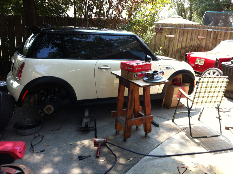

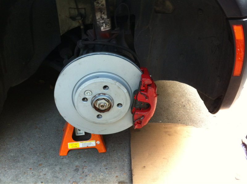

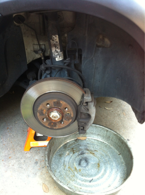

Finished up yesterday. Took all day because I was to stubborn to read the damn tech article.
A few pics:
Ok, so that's not part of the brake job,
