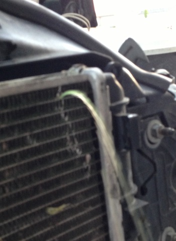

I get everything connected, wired, etc..... coolant, turn the water pump on and add more coolant to bleed the air... and then this happens. See photo.....
My little brother came over and knocked my radiator down and punched a F#@%KING!!!! Hole in it!!!!!!!!!!!!!!!!!!!!!!!!!!!!!!!!!!!!!!!!!!!!!!!! !!!!!!!
I'm PISSED!!!!!!

Good news, everything else is working !!! Haha.
Be optimistic ! Atleast from here its not too bad and maybe a time for an upgrade ??

Dang, that sucks...not being able to finish the job after doing all that work is very frustrating, not to mention now you have to buy another radiator. Hopefully you get it done soon so we can see the pics.

Ok just returned from the repair shop. Radiator is going back into the Mini. Its been welded. Cost me 60 dollars. My brother said he isnt going to pay for it so looks like I will be beating 60 bucks out of his @zz!

Ok the radiator is in. I've had to make a few mods with included some copper hot water heater fittings. Stupid me didnt get ends to braze longer ends so I had to fudge with ruffing up the copper and creating spikes in the metal then using sealant on the metal and hoses. I also ruffed up the inside of the hoses. Then applied sealant to both sides and let it dry. Anyway I ran it for 30 min and no leaks so far. Turned it off and let it cool down. Im putting it all back together. Test run later around town. Wish me luck.
