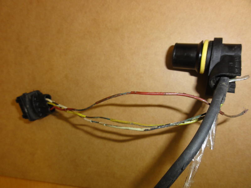

So, I looked at the trans diagram online and decided to pull the Speed Sensor in the transmission.
Quick version: Pull battery, remove battery box and it’s right there below. A metal pin holds the connector to the wiring harness (don’t lose it, use some needle nose pliers and boom it’s off), 10mm sock removes the sensor from trans. Nothing leaks if it’s not running so no messy worries.
It looked fine until I noticed a small break in the connection, on the sensor side. I will try to upload a photo, but the ENTIRE set of wires were either fried or corroded green and no longer shielded! I mean toasted! Can’t believe the car didn’t scream more at me!
I ordered the speed sensor MINI part: 24357518732 and the o-ring is 24357518749 (don’t buy it, it comes with it, I wasted $8) from Classic MINI and got 20% off as NAM member.
Spent less than $250, installed it in 10 minutes, put battery and box back in for a total of about an hour labor. Started the car, no codes, lights, nothing. Took it out for a spin and the shifting is clean and smooth.

I looked at my shifter, the circuit board next to the shifter and did adaptations on the CVT and it was this shorted out sensor.
Lesson learned. Read the codes and do it again and again. They are stored in the computer and now I know.
