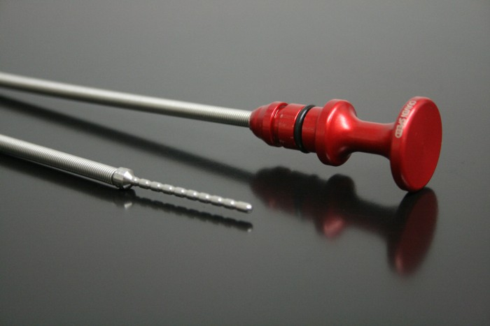

The one pic is from cravenspeed website and the other is what I received. You can clearly tell its a different design which is probably why it doesn't fit snug.

Yes, the o-ring is the problem. They put the 10 cent one on them instead of the 15 cent one. I bought 3 of the f___ers and they are all the same. I'm a little more than a little disappointed.

It appears that the o-ring is the wrong size.
They may just ship you all new o-rings as they are easy to install.

Good morning, NAM. Sounds like we ran into a problem over the weekend. Well, the solution is already in place, so fear not.
Almost all of the dipsticks for this group buy were assembled just last week as quickly as possible to get them out to you. It looks like the one's that were made last week were made with the wrong o-ring. Not a cheap one, not the one out of the wrong bin (we are better organized than that). We got sent the wrong size, then we went ahead and sent you the wrong size. Either way, I know it is our fault, and we apologize. Here is how we are going to fix it;
http://www.cravenspeed.com/dipstick-o-ring/
Follow the link, put the free part in your cart, and checkout for free. We'll have the correct sized o-rings here tomorrow and we'll send them right back out as soon as we can.
Thanks for your patience and understanding, I am sorry about the error.

Just R56, and not everyone's. If yours fits well then you do not need to make any change. Only the one's that were most recently assembled have an installed OD of .375 instead of .4, some of you have or will receive properly fitting units.

We've been doing some test fitting today and found that if you carefully remove the oring from the stock dipstick it will work on the Craven dipstick.
We are holding all the R56 dipstick orders from the weekend till we get the correct orings on them and will ship asap once the correct rings are in place.

The o ring on the original dipstick does fit on the Cravenspeed. I just tried it. I'm going to get new o ring though because the old one IS old and tired.
