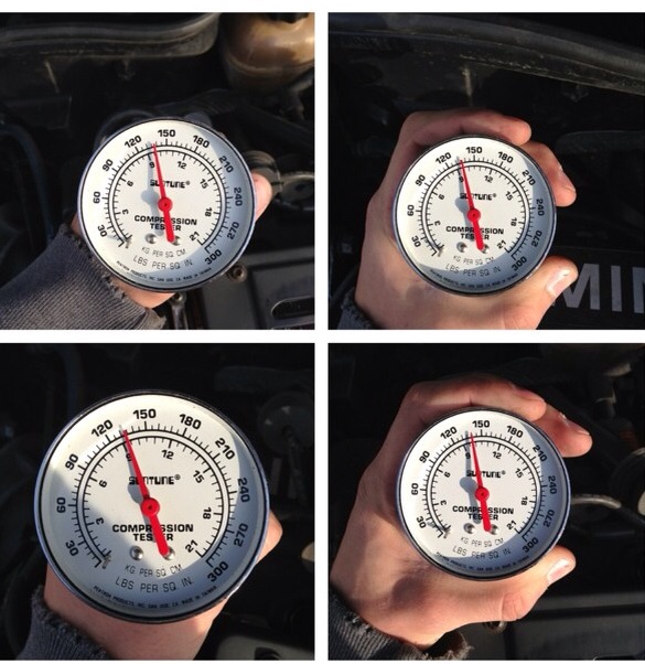

May I suggest a careful compression check - before you even get started?
The results might change your priorities - and it might be best to know beforehand.
Cheers,
Charlie
Old Jan 23, 2013 | 12:02 PM
Cheers,
Charlie
It was the very first thing that I did soon after deciding to make it a track car

Most important thing, even though I'm considering a rebuild by the next season
