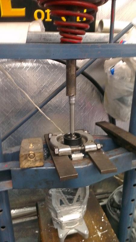

and for those stubborn ones where the correct puller still isnt enough try this
Attached Thumbnails Help! which Supercharger pulley/package to choose?-imag0200.jpg
