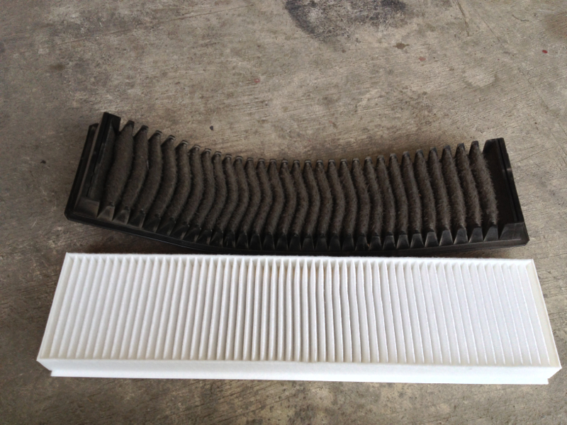

Always change your cabin filter. Yikes. I was wondering why the blower seemed to blow less air and had a funky smell when starting up. Now, all is well!
Anyone want a close up picture? lol
