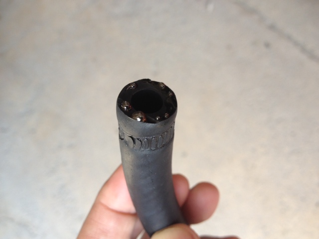

Knowing the Gates fuel line that replaced the torn OEM pump tube was just an SAE 30r7, I didn't want to wait too long to replace it w/ hopefully a lifetime fix. Devised a metal tube coupled w/ SAE 30r10 end tubes to replace the 2 day old fix. True enough, lucky to have dug in the tank again. The 2day old tube submerged in petrol showed rapid deterioration. Pic would show bloating, permeation & it's now a soft tube. Imagine if that had stayed a few days longer.
Hope this will guide those who might have same problem.
