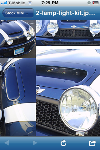

I don't have any close up pictures of mine, but I can tell you that the grill has dremel cut slits that the brackets feed through.
A quick Google search turned up this: http://www.mini-madness.com/ProductI...-light-kit.jpg
which isn't the best for detail, but gives a good reference to look at.

Hey thanks for all this. The image in the link look sweet IMO.
That's basically all I was looking for. Good googleing!!! And again thank you so much. My car has the stock chrome & body matched inserts right now, but am looking to switch in up to this now!!
