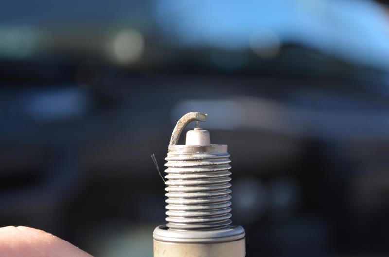

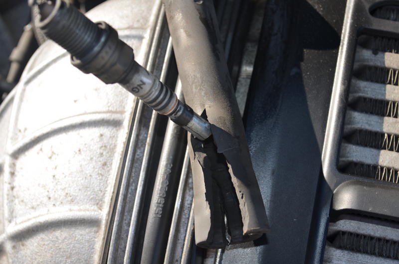

I was on my way home from work, not driving fast, not accelerating hard, just taking it easy. But then i gave it a little gas to pick up with traffic, I heard a pop, so I started to pull over, the check engine light started to flash, the traction light came on as well as the EML light. Popped the hood and the cylinder 1 spark plug was sitting on top of the intercooler. The threads weren't stripped that I could see, but it did look like it was hit. So before i tow it anywhere does anyone have any advice?

maybe the plug was not tightened down or was tigtend down with a hot engine. can you see what the threads on the head look like? ( have a flashlight?)
the prong looks like its bent, probably happened from banging around the engine bay. gap it and put it back in. the split plug wires dont look good to me. but i have never dealt with a car that had these wires before and i have not even pulled my plugs yet.

In the pic below, it appears that the washer on the plug is not compressed. It's possible that the person who installed it forgot to torque it down.
+1
good catch. Those one time use crush washers SHOULD be flattened after use.
