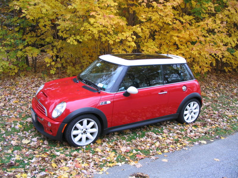

  #68
Bino's Avatar
Bino
Joined: May 2003
Posts: 35
From: Somers, NY
2003 MINI Cooper S hatchback (R53) with 175,000 miles.
Purchased new in June 2003. Original engine, 6-speed manual gearbox, and clutch. Synthetic engine oil has been changed every 10K miles. My one and only "mod": I added Koni FSD shocks at 90K miles. Had to replace the manifold/catalytic converter section of the exhaust system just this month. Various minor electric glitches over the years with windows and door locks. Original windshield finally cracked - spontaneously! - after about seven years. Seal around rear license plate light leaked, so it needed minor body work to repair the rust on the hatch. The power steering pump was replaced at about five years. After my *fourth* expensive Zenon headlamp unit died last year, I swapped them out for plain old thirty-dollar halogens. I have a set of 185/65-15 snow tires on 15x6 steel rims that I use from December through March each year. My summer tires are 205/45-17 on the original 17x7 rims. Right now I'm on my third set of snow tires and fourth set of summer tires, and only the original summer tires were run-flats. Car only uses about a half quart of oil between changes and still gets 34 MPG at 75 MPH with A/C on during long road trips.
I love this car. I might give it to my son, but I will never sell it.
