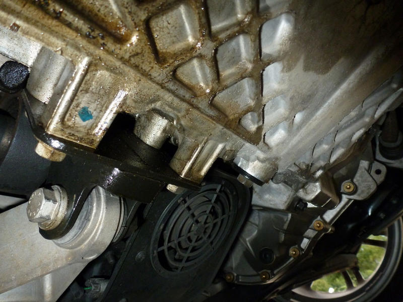

I have a hard time getting under the car also to look, so I took some blind shots with my camera to see what I could find. Is this an oil pan leak or a crank seal leak?
