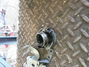

55k :( I only was able to get 10k miles out of the car after buying it before the throwout bearing exploded. Now I need a new flywheel clutch and transmission. :( just found this out today. My transmission has holes in it. Another case of blindly buying a mini. Clearly the car had a very hard life before me.
Attachment 77300
Sorry to hear that. Is that going through to the inside of the transmission or to the outside air? If just to the outside, I would patch it with some JB weld and call it good.
If it is going to the inside of the transmission, JB weld might also work if it is not a spot with structural importance. JB weld stands up to oil and heat just fine. I have used it to repair cracks and holes in valve covers and motorcycle clutch covers with good success.

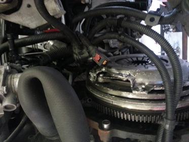

The holes are through to the inside of the transmission. Metal shavings are probably in the bearings so those are probably destroyed as well. The car is at a local shop for what I was expecting to just be a clutch job. On the bright side its going to have a spec flywheel and stage 2 clutch going in whenever a new transmission is sourced or if this one gets fixed...if its even repairable. Heres what the clutch looked like and the throwout bearing. Sorry for the low quality pics but I'm on my phone on the NAM app.
