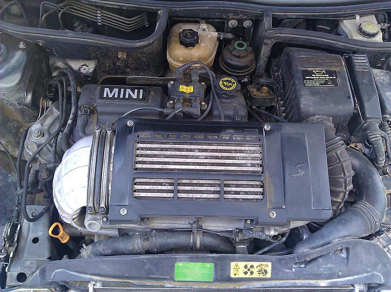

3rd) here is a photo of my motor bay, can you tell me if its complete or if something is missing???

3) From your photo the only thing I see missing is the cover that is suppose to be on the positive battery cable junction to prevent it from shorting out. Other than than that I would suggest a good cleaning and service.
