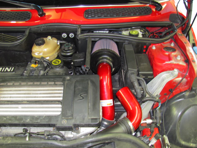

New K&N Typhoon air filter kit came in this week. I bought it from Crutchfield and it's my first owner-installed upgrade on my 2002 MCS. It was a little tight getting it in there but it looks great, sounds great. Can't wait for warmer weather to wring 'er out.

Where in CO are you at?

I'm over on the western slope southeast of Grand Junction. I joined the 5280 Club a couple of months ago right after I bought my MCS. I'm already planning to join whoever is headed to Las Vegas in May. Since I'm 200+ miles away from Denver, it's not likely that I'd drop by for a meeting unless I'm in town (which sometimes is a possibility). Look forward to meeting more of the 5280 crowd!

Great job with your intake, if you want to follow my build up this is the place. There's much more to come: the tuning is geting done in a few days up to a week, after that the entire suspension is geting changed out and set up. Then it will be small miscellaneous projects (like hiding all the wiring in the back of the car, making an air diverter for the DFIC, etc...) up until spring when I can start on the body and paint.
