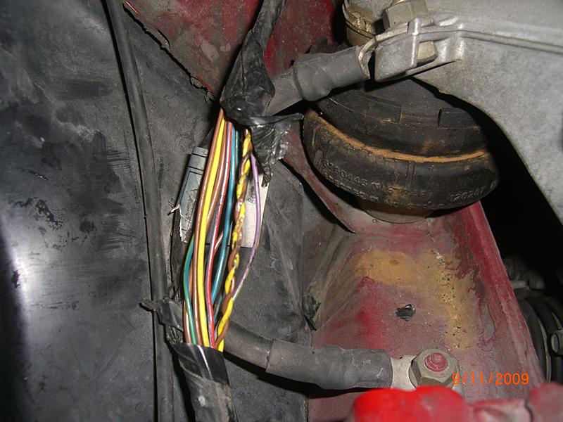

I looked under the hood by the passenger side and checked the ground cable for the starter and it was secure.
HOWEVER, I found the harness next to that ground strap chafed and a couple of wires exposed. They are the brown and yellow wires that are pigtailed together. I don't know what they are (attached pics are of those wires). I haven't re wired, but I managed to separate them so as to make sure they don't touch each other.
