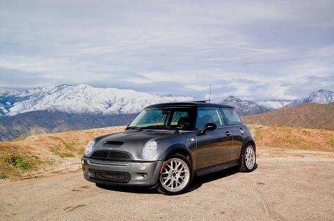

Hey guys im about to put on my bottom aero grill. After reading all these post on how to install them im deciding that im gonna to do it with the bumper on removing the stock and putting the new grill in. Is there anything else i should be aware of when cutting. Just dont want to mess up the bumper.. Thanks

ok so today i installed the bottom grill and i thought i try something different I left the top tabs on but cut off all the bottom tabs. Now the grill fits in but it isnt flushed all the way. The top and bottom corners and still sticking out also the whole bottom wont even get flushed because it feels like the center is making it bulge out. Did u cut the center peice to make it flushed? Anybody have any suggestions. I think i am just gonna pull it out again and cut off all the tabs and use 3m tape. Or do u think i should just get another bottom piece and leave the tabs. And the double side tape took for ever take come off. thanks
