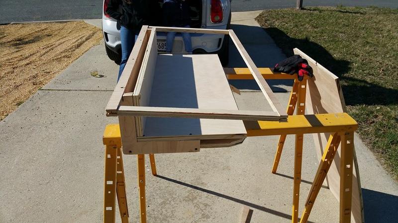

I will be posting my pics long the way and answering any questions.
This is a lease so everything has to return back to stock before i turn it in. So keep that in mind.

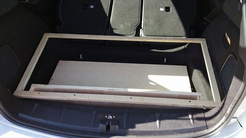

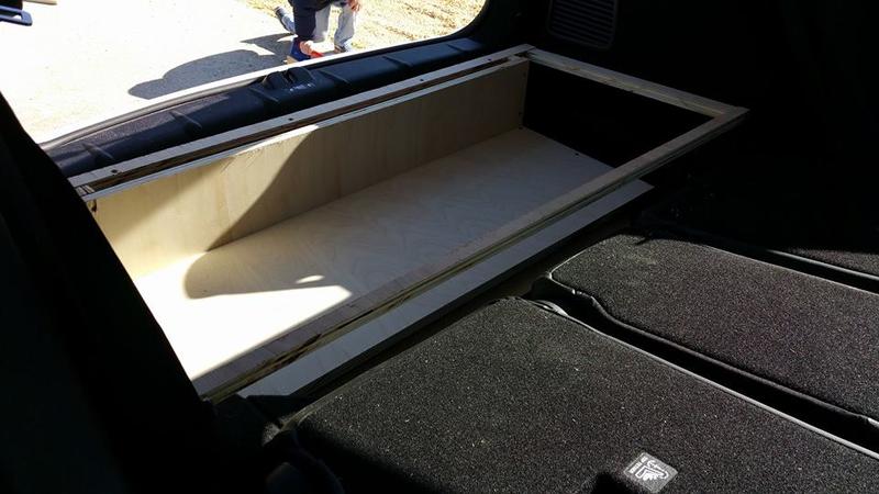

First thing i am building is the False Floor Sub box for 3 soundqubed 8"s
Attached Thumbnails 2015 Sound Quality Build-7.jpg   2015 Sound Quality Build-5.jpg   2015 Sound Quality Build-8.jpg   2015 Sound Quality Build-10.jpg   2015 Sound Quality Build-3.jpg
2015 Sound Quality Build-6.jpg   2015 Sound Quality Build-1.jpg   2015 Sound Quality Build-2.jpg
Old Mar 30, 2015 | 06:55 PM
Audiovideo1979's Avatar
Audiovideo1979
Joined: Mar 2015
Posts: 12
The fibeglass should be here this week so i can finish over the weekend

I took 3/4 inch birch and covered it with carpet to create a false floor.
And this is what it looks like with the mat on it

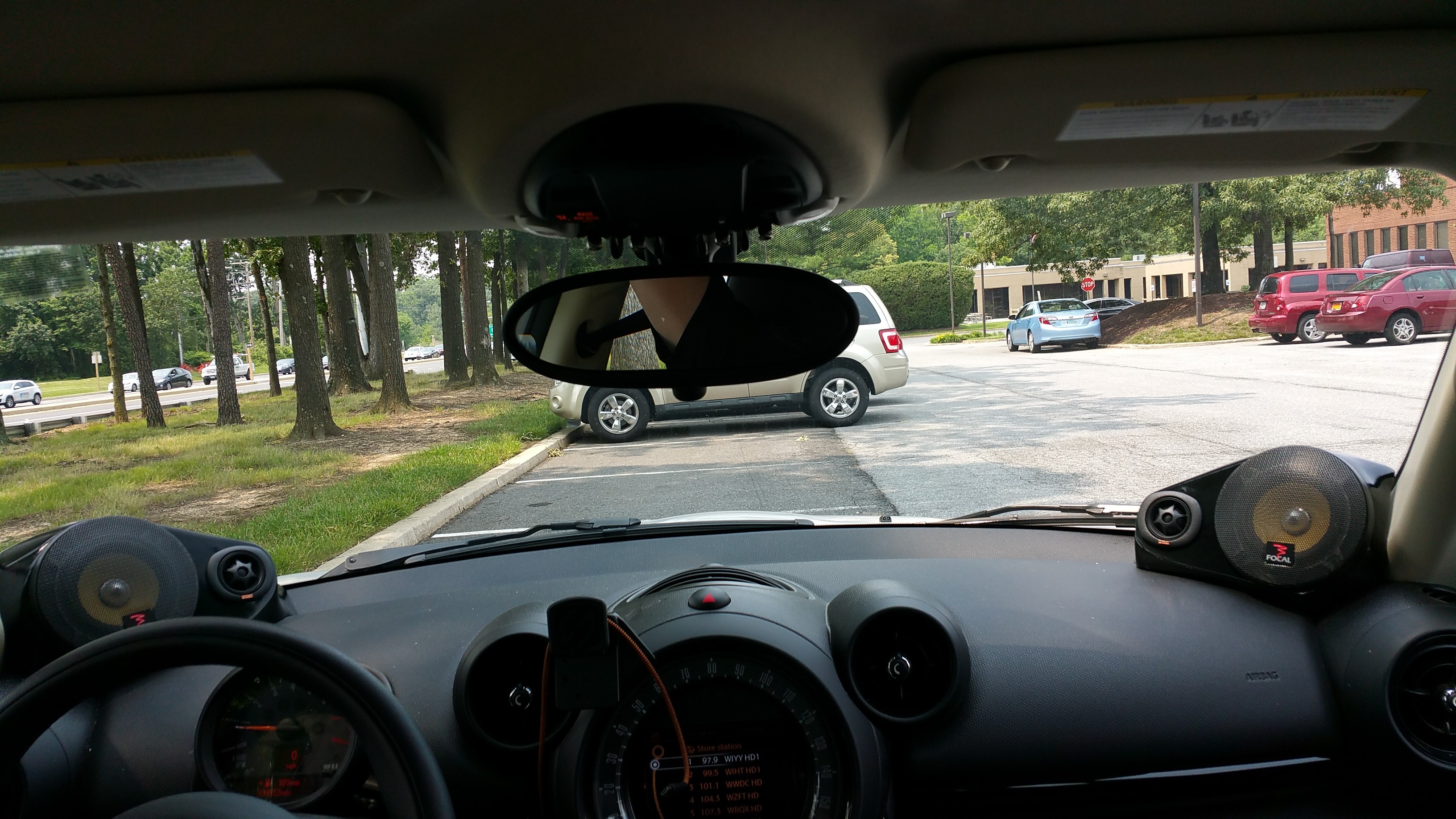

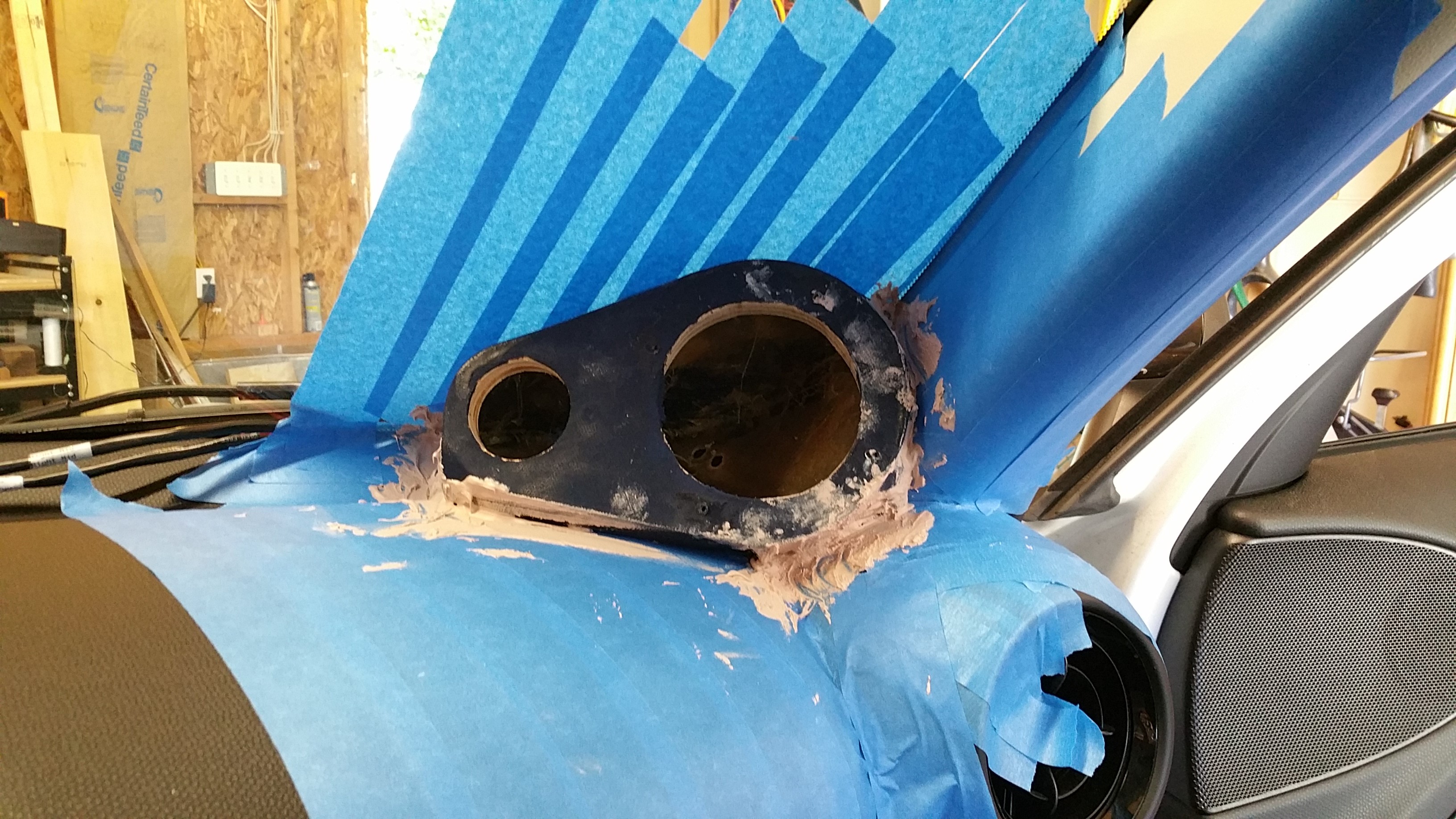

2nd times a charm. i still need to finish the pods with bondo and paint. the trunk just need wire wrap and grills. i may tap into the speakers under the seat but for now i am just using the dash and subs.
and yes that is a ph15.

Looks good. Have you thought about doing those speaker pods in the kick panels to give you a better shot at equal path lengths and sound stage? The passenger legs might get in the way but with some tweaking I would imagine that you should get a better stage. I know many manufactures do speakers on the dash and high in the doors. Coming from the car audio side the kick panels were always the best spot that we found when it came to getting a more realistic sound stage.
Good luck though with finishing it up.

Just my opinion, but I'm not a fan of those large pods up on the dash. Too bulky and intrusive. But take that with a grain of salt as that's only my opinion and opinions are a dime a dozen.
I think in the CM the idea position for the tweeter/mid combo is using the 4" location for the mid and the tweeter in the sail panels. They are nice and close (tweet and mid) and wide (off-axis to your hearing path). Time alignment and aiming should be able to correct the path lengths easily. The only down side to the sail panels for the tweeters is it limits the size of the tweeter due to the vent that blow air across to the window also being right there. AND, the 4" factory location is a bit blocked by the dash....... but car audio is a compromise regardless.
Anyways, just my $0.02

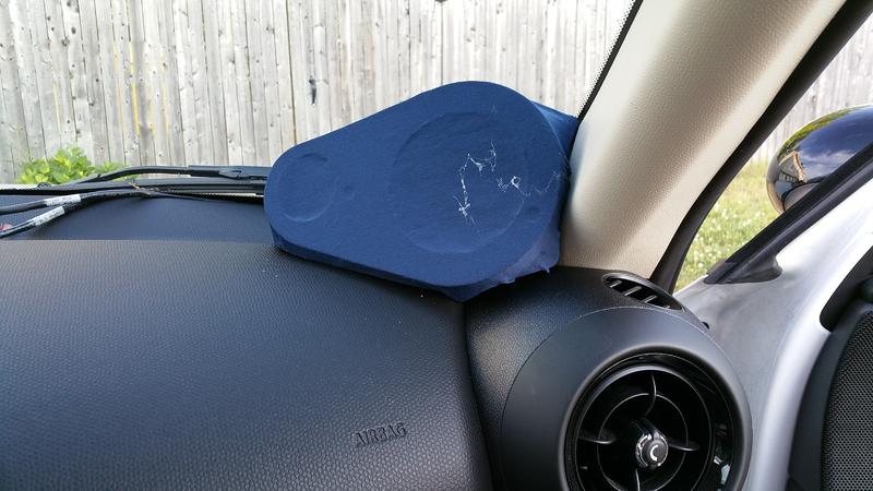

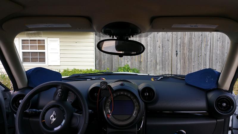

Bondo and painted! Finally finished!
Attached Thumbnails 2015 Sound Quality Build-20150530_143638.jpg   2015 Sound Quality Build-20150610_115234.jpg
Old Jun 10, 2015 | 06:43 PM
Audiovideo1979
Joined: Mar 2015
Posts: 12
The main reason i did it this way is because its a lease and i did not want to cut any wires or into any panels everything can be take out with no damage to the original car. I am 6'4 so those speakers do not obstruct my view at all.
