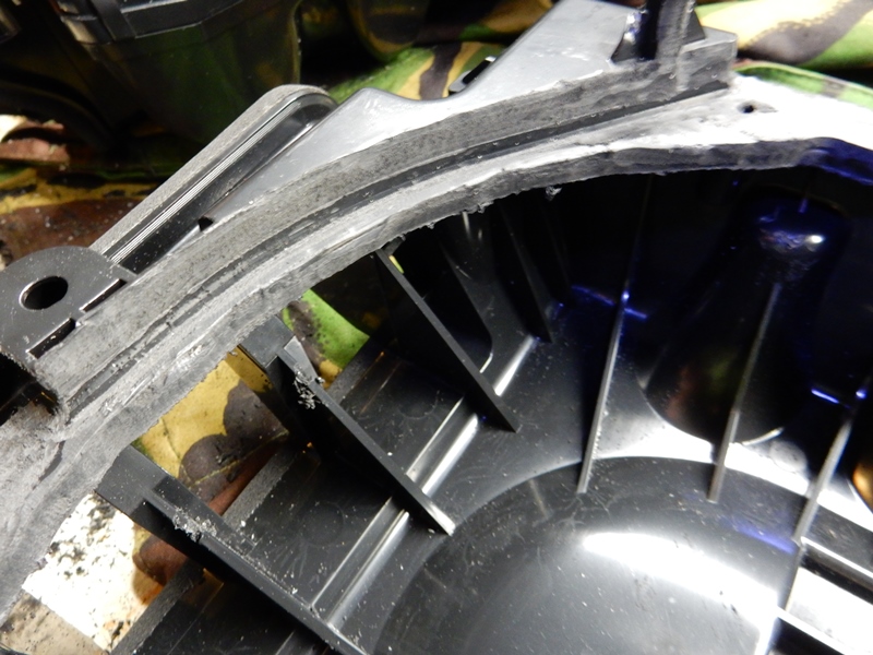

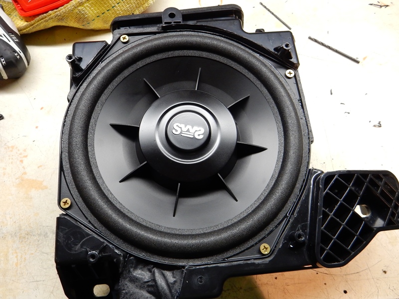

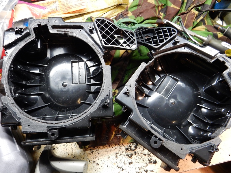

Drop in replacement (almost) for the stock 6.5" under seat bass drivers.
Some minor modifications to the enclosure were necessary to get the speaker to sit flush. The opening needed about 1/8" trimmed off. Screw holes lined up perfectly.

I am sure just replacing the speakers will result in an improvement, but as you say, the amp really lets them shine. Most of the power of the HU goes to driving the bass drivers, and the stock radio is notoriously underpowered.
You could do the drivers first and then add the amp later, but once you have the seats out and the drivers removed, integrating the amp is relatively straightforward.

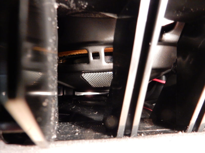

As far as getting the drivers to sit flush in the enclosure, making a good acoustic seal is important for the design. In addition the enclosure uses the door channel cavity as a resonance chamber. Without a good seal this would be compromised. The time and effort you would make to get a good seal with the resultant gap is equivalent to the trimming that would make them flush IMO. In any speaker design (especially bass drivers) it is important that the acoustic space in front of and in back of the driver are as isolated as possible. Also the SWS-8X lists the driver excursion as 1 1/2". The 1/4 " of clearance you would lose might result in the driver hitting the grille.
