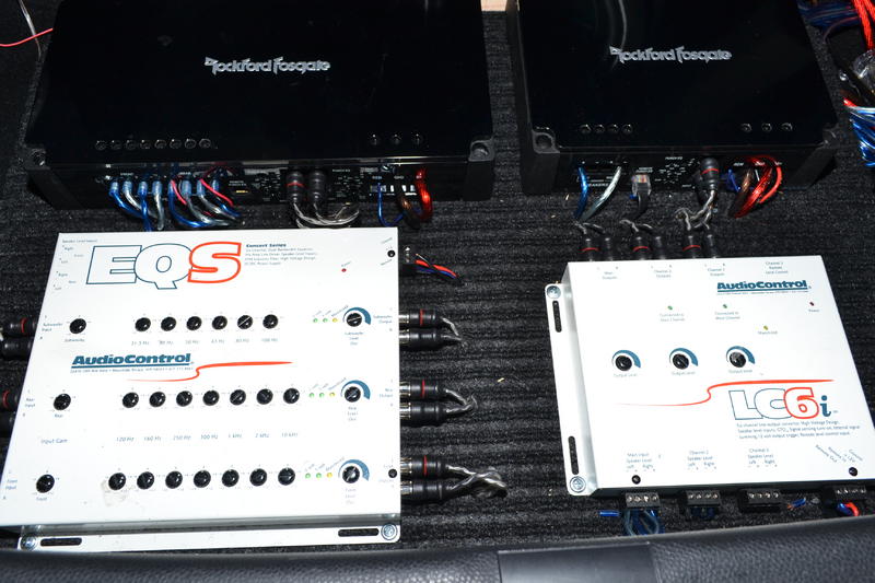

I have a sub enclosure and amp from a previous car and was wondering what the difficulty level of integrating it into my CM's stock HK system would be.
I would not do it myself, but I'm asking because I seriously doubt many shops around here have worked on Countrymen.
If it's pretty straight forward, I wouldn't mind taking it to a reputable shop to get it done. Please advise.

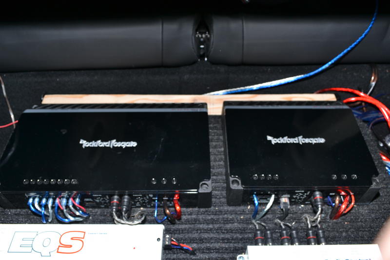

I have a HK sound system. You will need a line converter, eq if you need it it, amps and of course aftermarket speakers.
Attached Thumbnails Adding amp/sub to HK system-dsc_6219.jpg   Adding amp/sub to HK system-dsc_6222.jpg
