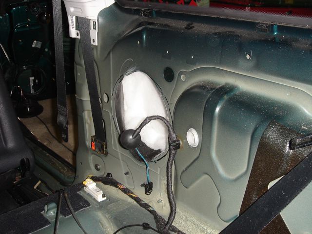

For those that did the rear 6x9 replacements, did any one notice if there was excess room back there?
From the photos it looks like the whole is cut into the metal, is this correct?
Think this could be widened to fit a shallow mount 10" sub? Illusion audio has had these type of subs forever, but looks like others are catching on. Hardest part of this if it would fit would be getting it a sealed enclosure.
Also like to thank everyone else for all the great info on this thread and will be replacing the front stage with focals shortly. Had a set of the polyglass in my accord for the past 7 years and really miss them.
A guy from Austria widened the hole for a 20cm (~ 7.87") sub:
http://www.mini2.info/forum/attachme...2&d=1205756040
From the photos it looks like the hole is cut into the metal, is this correct?
Having just been in there:
1. There's a LOT of depth there -- nothing to stop a deep speaker with a big honking magnet until you hit the metal for the outside of the car.
2. The 6x9 hole IS cut into the metal.
3. I DOUBT you could fit a 10" sub ... problem is not depth, but that the metal panel on the inside of the car is irregularly stamped for rigidity's sake just outside that 6x9 area (see photo in gallery); to get a good mechanical attachment of speaker to car, you could probably find the 10" span of smooth metal in the vertical direction, but not in the horizontal.
Suggestion: go get the biggest, baddest 6x9s you can find ... they'll probably fit.
