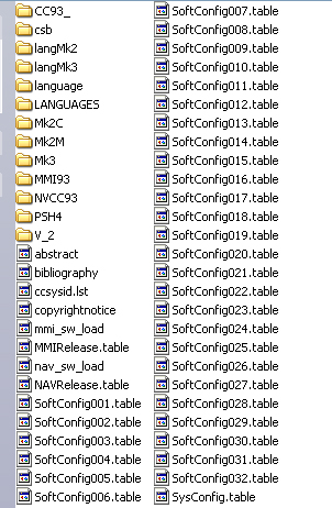

I used Alcohol 120%. Downloaded the Rar file. Unstuffed it. Went into disc image wizard in A120%. Found the image file in the unstuffed Rar file. And burned it at the slowest speed 4X.
Below is a shot of the files on the burned CD.

Right, just burn the image to the CD.

Hopefully burning a new disc or using your friend's will work. I did exactly the same steps you did, and mine installed flawlessly; also the contents of your disc look correct.
