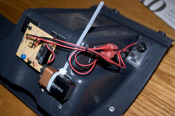

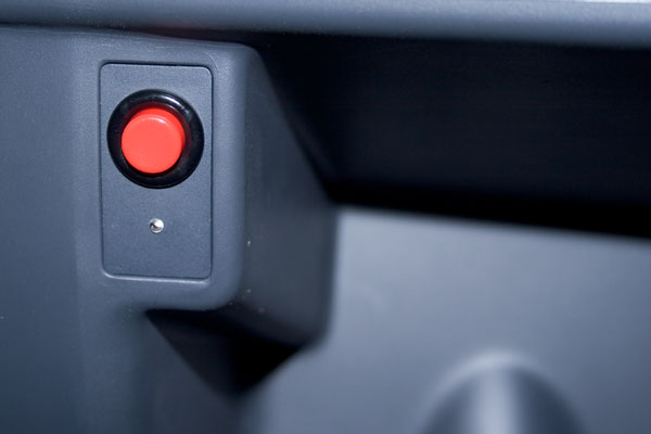

I got the garage door opener installed! I don't know if I'd get across the US/Canada border with it, but I think I did a decent job. The pushbutton required a .72" diameter hole! Very close to the edges of the blanking plate. I used a 3mm ORANGE LED, so that it matches my interior lighting (I also could have used a 5mm LED, but stuck with the smaller size. I got the LED from:
www.lsdiodes.com
who are not terribly expensive when you consider Radio Shack and Digikey, etc... Shipping was fast and professional. The only regret I have is not sanding the LED so it was diffused. If I have to take the blanking plate out, I'd sand it.
The switch looks like a miniature version of an arcade game button. Pretty cool. I haven't made a decal/sticker yet to say something like "Tacks" or "Oil Slick" but will...
Attached Thumbnails Aux. in install-pushbutton.jpg   Aux. in install-pushbutton_back.jpg

Ugh. Stoopid me. I am going to change it tonight, ye know that? In the meantime, I have blacked the combination out, though thankfully, it's a bit difficult to resolve the code, and there are more positions than shown! Ha!
Sigh.

ururk - that's awesome!!! It looks just like an old Atari joystick button!

Ok, changed the code. My brother is going to be a bit upset when he gets home tonight, though . Hopefully he'll listen to his cell voicemail :D

And for those who want to know, the switch is:
Made by NTE
SPST
Momentary, Normally Open
Part number: 54-385
www.nteinc.com
Data Sheet (for some reason, the switch is grey, but the description says red, probably placed a grayscale image in the PDF):
http://www.nteinc.com/switches/pdf/pg18.pdf
I got the part at the local electronics store (www.purchaseradio.com). I doubt they do mail order, and I'm sure it's not worth the time trying to order a switch from them.
I was tempted to use a vandal proof switch, but they cost around 15.00 a switch! And didn't come in red.
