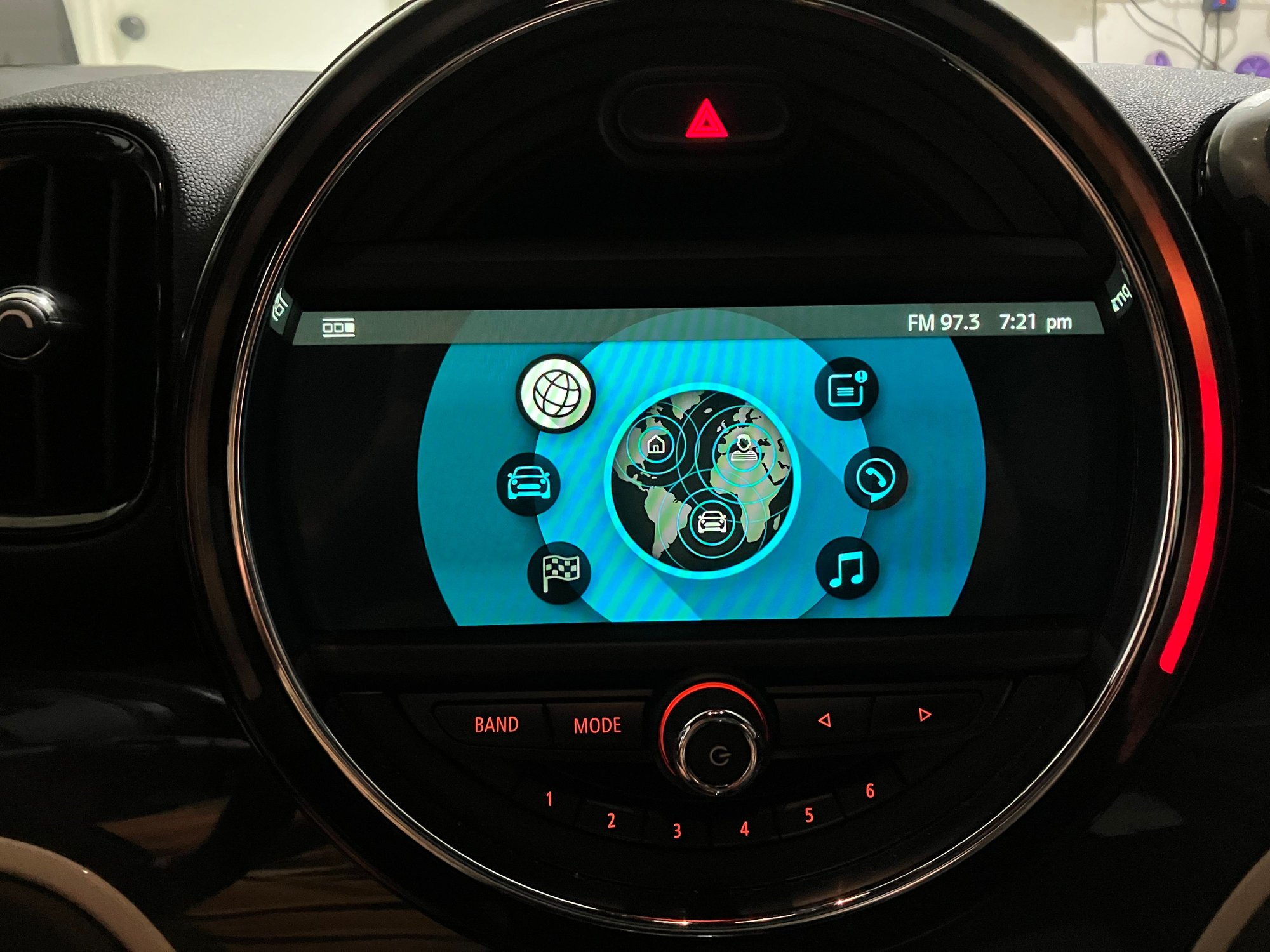

I am in need of help. I have a 2018 F60 JCW with the large touchscreen and (until recently) the stock Nav system with no CarPlay.
I just flashed my car with a tune, Bootmod3 Stage 1, and wouldn’t you know it, when I start it up, the Nav no longer functions. I see the icon on the main screen, but it is greyed out and I cannot even enter that part of the infotainment.
I asked Bootmod3, no help. Do I simply need to reload maps onto the car, or is there something else going on? If I need new maps, what’s the best place to get them? (Dealer, aftermarket?)
Map icon greyed out- clicking on it does nothing.

Looks like the issue was loss of maps- thanks to sb2002 for the assistance!
