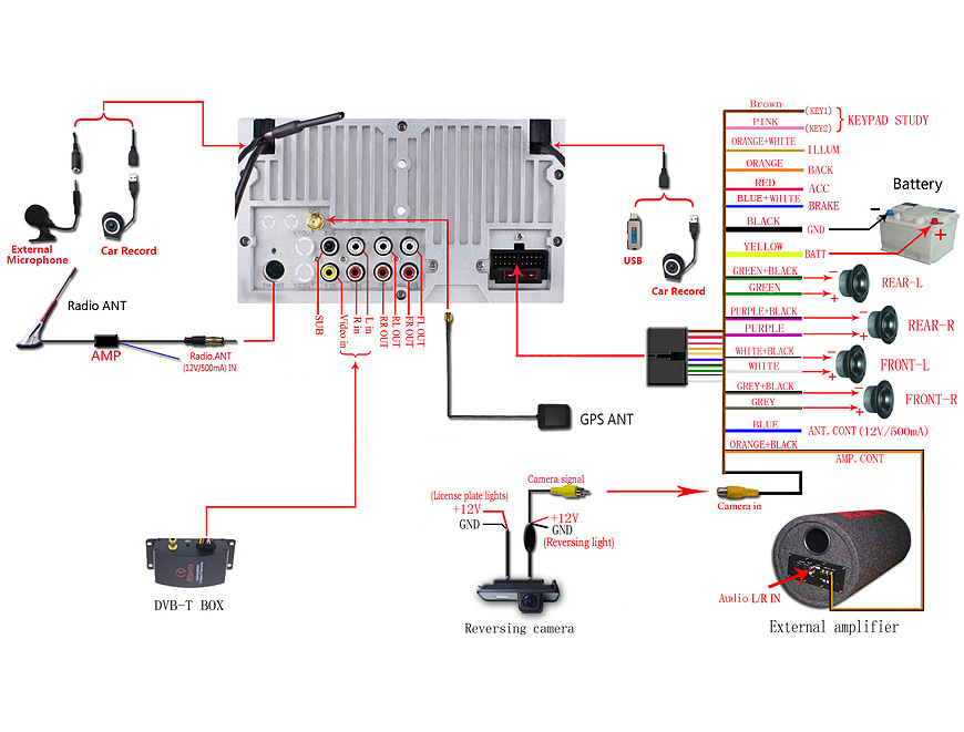

Do we have an Hk enabler specialist here ?
Just bought this Joying unit for ma R53 HK AMP model, bought an Hk enabler as well but no sound, Blue wire from Enabler is empty to my unit , do i need to wire AMP CONT or ANT CONT on it ? many thanks !
Joying head unit wiring
