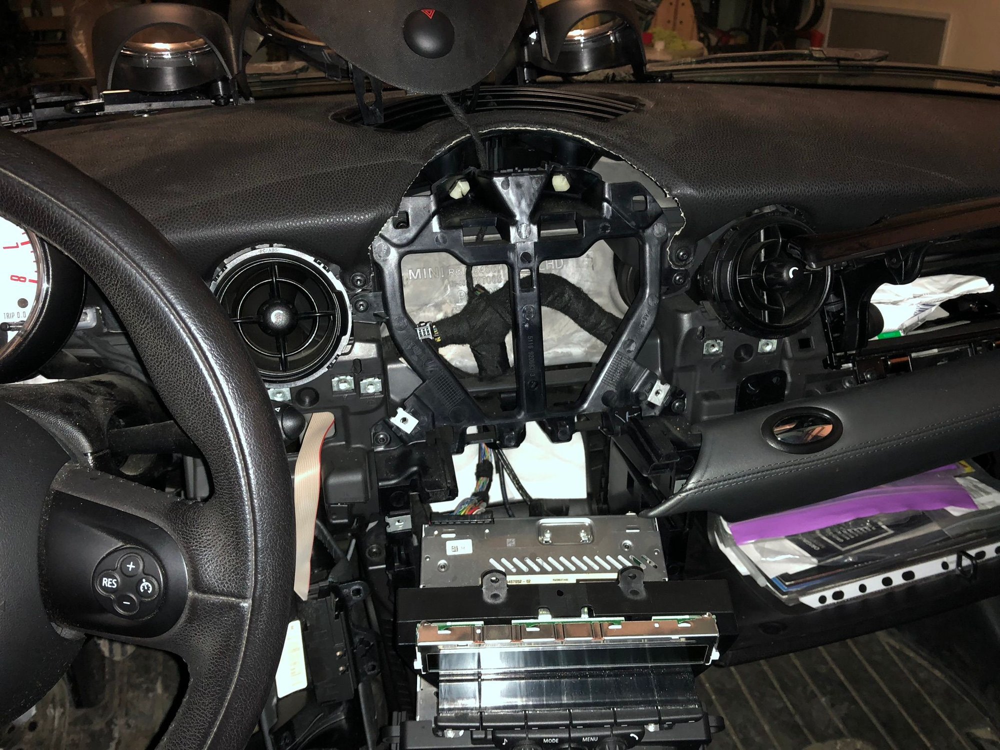

Another thing, since I am probably doing this myself, would I have to remove the entire panels, from the tachometer to the hidden glove box, or can I just remove the center stack since I already have the Metra kit installed?

As far as I know Metra dash kit uses the same mounting points as the factory panel it replaces. So you will have to remove all the panels around in order to get access to 4 screws that are used to hold it in place.
To give you an idea, here is a picture of my 2012 S R56 when I was upgrading my radio:
