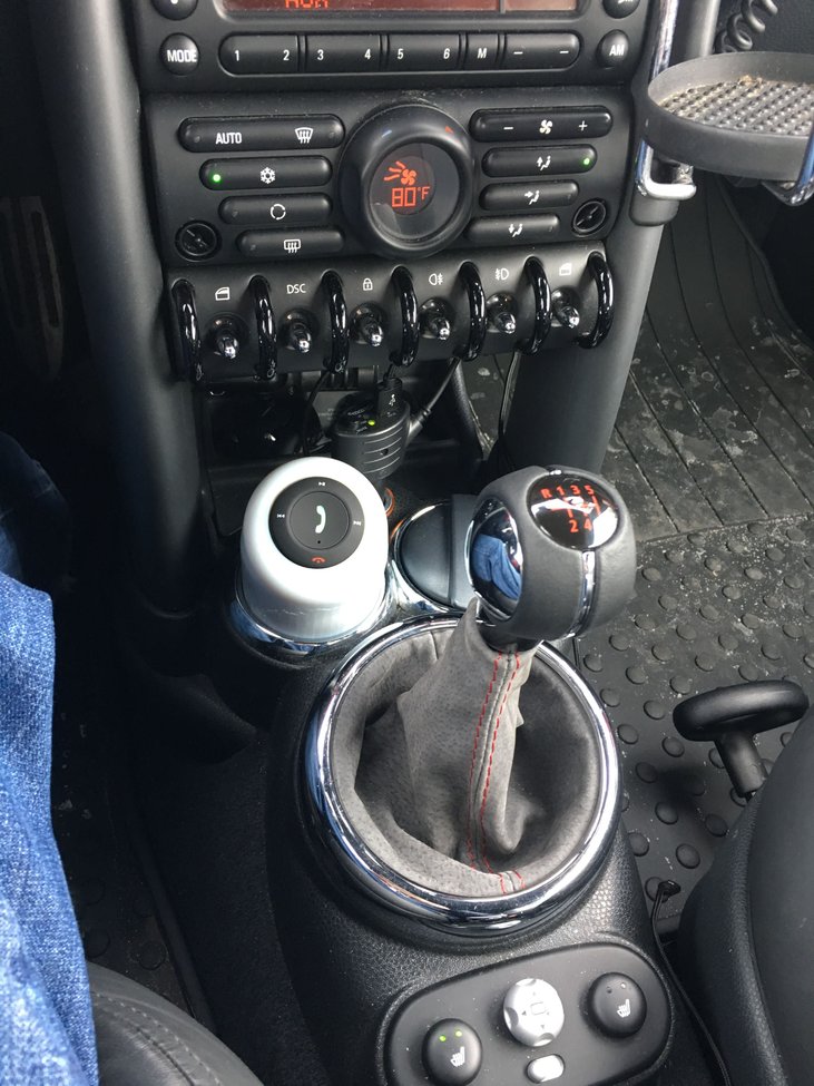

H C - what unit did you end up with?
subw00er - what shift **** to you have on your car?
Attached Thumbnails Need advice on adding Bluetooth-345660fa_f3e9_4980_b58a_986d18c32dbc_be6ae945493917a093f3199b5d68de7c0544bfed.jpeg
