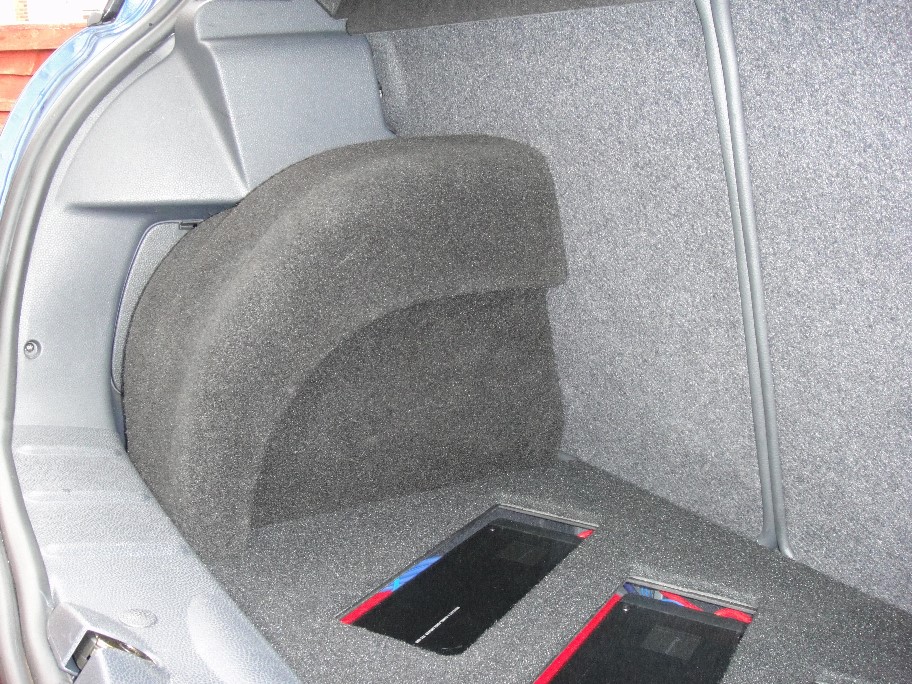

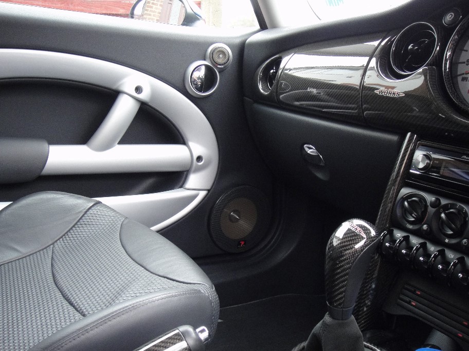

I upgraded the system in my old R50.
Here are some pics, took me a while to fit everything but I really enjoyed the challenge. It sounded wonderful.
System: Pioneer DEH-P88RSll Headunit, 3 Pioneer PRS-D800 amps, Focal KR2 16cm front speakers, JL Audio stealth sub, Hertz HCX690 rear speakers, Pioneer CDX-P670 CD changer.
Attached Thumbnails Sound System-dsc00345.jpg   Sound System-dsc00340.jpg   Sound System-dsc00333.jpg   Sound System-dsc00334.jpg   Sound System-dsc00331.jpg

Wow - very nice job! My only issue with that would be that the battery tray is in the rear .. and would be located under all that.
I'm sure there must be a way around that problem.
Being a Cooper, it wasn't an issue I had to address, but I'm pretty sure with some planning you could get around that.
