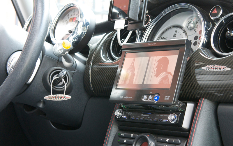

Here's my iPhone cable routing solution. Ran behind dash and notched the dash panel just enough to clear the iPhone cable.
Attachment 68152
Looks like Mission Control in there, Mike :-)
