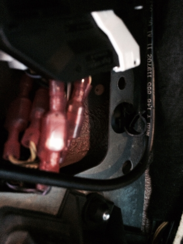

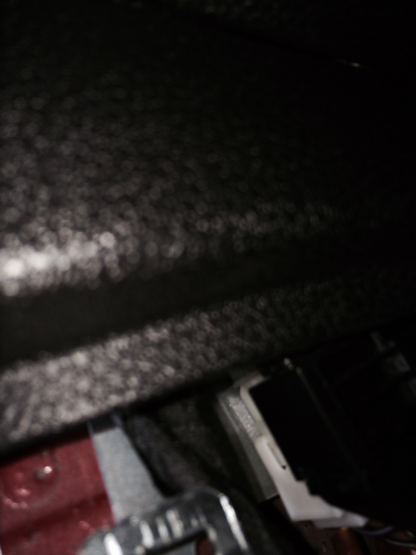

I had quite a fright on this. I un-hooked the negative ground from the battery. Then, one by one, I cut the speaker wires at the X9331 adapter. I put spade connectors on the ends and reattached the speaker wires together, figuring I'd check my connections, and then insert the amp. I reconnected the X9331. I reconnected battery, and and tried starting the car. It wouldn't start, I get tons of error lights and the wipers go on and won't turn off. After turning the car on an off, wiggling the two ends of the X9331, and paying particular attention to the white wire which goes to the starter, hooking and unhooking the connector above the X9331, unhooking the battery etc, I get the car to start and the wipers to operate normally. Now the only problem is a have an airbag light and I'm afraid to try and install the amp. As I was putting the X9331 and the connector above it back into the stud and turning in clockwise to lock it, I seemed to get a shock from the connector above the X9331. I disconnected the battery, unclipped both connectors and reconnected them. I think one or both of the connectors were not seated originally, although I had checked them. Any thoughts and comments would be appreciated. Edit I guess I've gone this far, and will probably install the amp, since the cutting into the car is done. I now have to figure out which direction from the x9331 goes to the head unit and which goes to the speakers. I put the spade connectors below the connector and I've attached a pic. Can anyone guide me on this? Once I have the amp in, then I'll reset the airbag light. Thanks in advance.
The female side of the X9331 comes from the radio.

Sometimes things like that happen when the battery is not connected tightly.

Thanks for the advice on the X9331 direction and a loose battery connection possibly causing these problems. I'll try and hook up the amp tonight. My local dealer quoted me a airbag reset fee of $225 but I found an independent who will it for $68. I noticed last night that my sport button is not working. The light was on, but it didn't make any difference whether it was on or off. I wonder if the airbag lights are on with that they disconnect the sport? That seems kind of strange.
