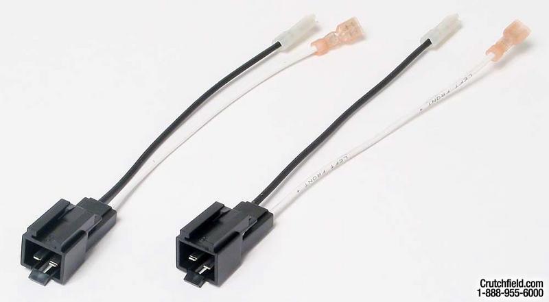

Aftermarket car audio speakers use a standard spade type connector which is pictured in the top right of the image. Unfortunately I could not find a speaker harness which is what the entire picture is that fits the mini cooper.

Thanks for the pic though. I may have to look for a harness to convert the new speaker to accept the factory plug.
It is really easy to cut the wires, install spade connectors attach to new speakers and move on. If you go to any stereo shop that is what they do. Or if you want to get fancy, break the connector off the old speakers and attach wires with spade connectors to go between the cars proprietary clip and aftermarket speaker standard spade clip like a homemade speaker harness for the Mini.
