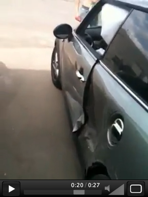

Ya, just my left arm is a bit scraped up. Car had 4 people in it, my scrapes and a couple soar backs was the worst of it. Car took the hit like a tank tho and deployed the side airbags, mini never fails to impress.
Got a chance to check it out again today, not sure it'll be write off??? I'm not an adjustor. The car that hit me pretty well crumpled their front end.
