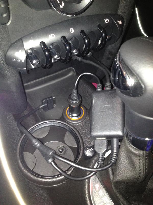

Really confused
I have a 2012 Mini with Mini Connected and NAV, and an iPhone 4S. The cable that came with it did not work. They then tried a snap in cable, which did connect, but wouldn't stay connected. They then gave me THIS monster, which works fine, but why is everyone else saying that other cables work? They charged me $298 for it. They said I was the first person to even ask for anything like this. I just got my car on May 29th, 2012. How could a CABLE cost that much? Did they rip me off????
$298!!! What a rip off! From the picture I can safely say they gave you a relay box that allows your phone to draw power from the 12V socket and the box connects to your phone via the standard Mini USB + A/V cable (which comes with the car). If this setup actually works while the cable alone doesn't, it can only be one of two reasons:
1. Something is wrong with your iphone 4S that it needs more power than it should, try another iphone with the standard cable.
2. Something is wrong with your car's USB port, the power output is too low. You should have it fixed under warranty.
You most definitely shouldn't be needing this "monster" and at $298 I feel very sorry for you.
Old Jul 9, 2012 | 08:33 PM
  #30
msmarti58's Avatar
msmarti58
Joined: May 2012
Posts: 16
From: Columbus Ohio
I did try another iPhone, not the 4S, just the 4, and it didn't work either. I MAY not need the other cable then, since I already have that, it came with the car. It's all over my head (I'm a woman and not electronically inclined).
