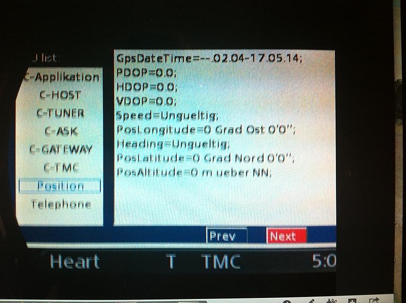

finally I managed to find how to put it in diagnostic mode and found some interesting info.
Under GPS location it says "ungueltig" according to a google seach it reaveals this means "Invalid".
So atleast I know the satnav knows sometings going wrong!

Old Feb 6, 2011 | 11:47 PM
onemcs's Avatar
onemcs
Joined: Jan 2011
Posts: 38
Please find attached photo

Based on that screenshot, My bet is your GPS antenna in the stack on your roof has gone bad, either corroded by water damage or has become disconnected. I think the movement you are seeing on the map is estimated movement based on the vehicle speed/steering wheel angle and not the GPS signal.
You might just be right there!
Mini said that they have connected it up to the computer and it seems that there is a loose connection or something has corroded etc. Therefore they have suggested to remove the headliner and see if they can see the fault. Only thing is that they want £130 or $208. Which i think seems a bit excessive. Therefore think im going to have a look myself before they charge that much. Problem being is that mini are the ones who really need to look at it.
