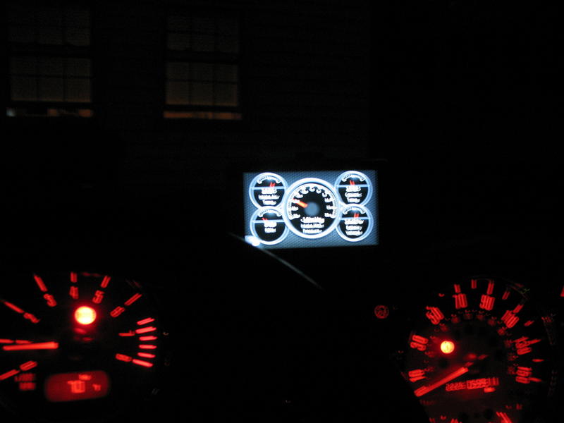

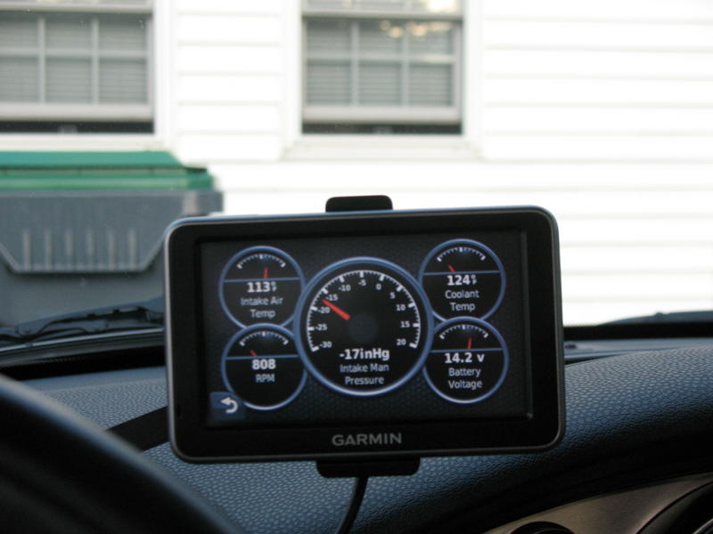

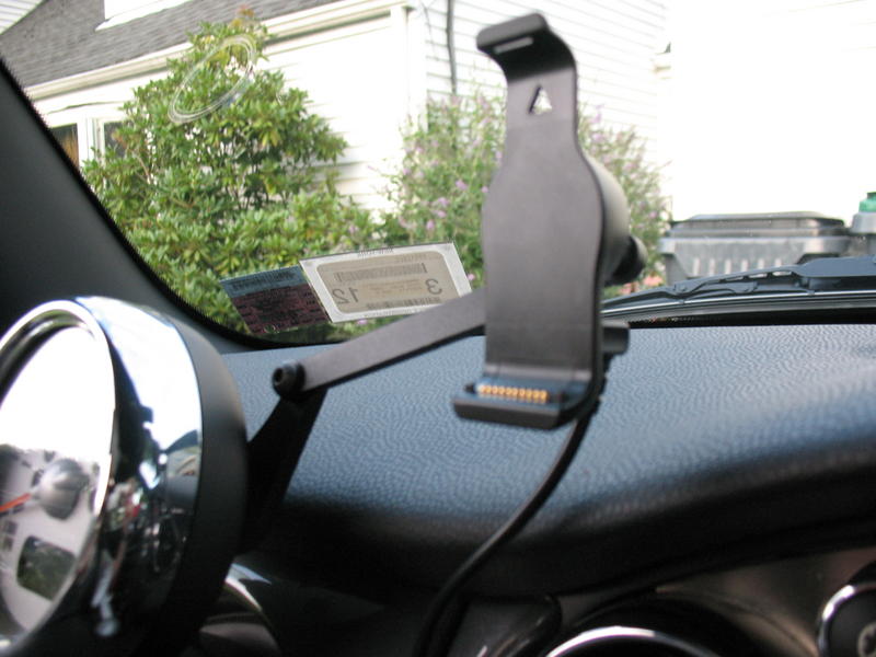

My mount
Just a few pics, love this set up
Attached Thumbnails Garmin EcoRoute-img_0313.jpg   Garmin EcoRoute-img_0314.jpg   Garmin EcoRoute-img_0320.jpg

parameters
Here you go...... INTAKE AIR TEMP, THROTTLE POSITION, INTAKE MANIFOLD PRESSURE, COOLANT TEMP, VOLTAGE, SPEED, RPM, TIMING ADVANCE, ENGINE LOAD. I love this for the cost installing oil pressure guage. It also clears codes...
