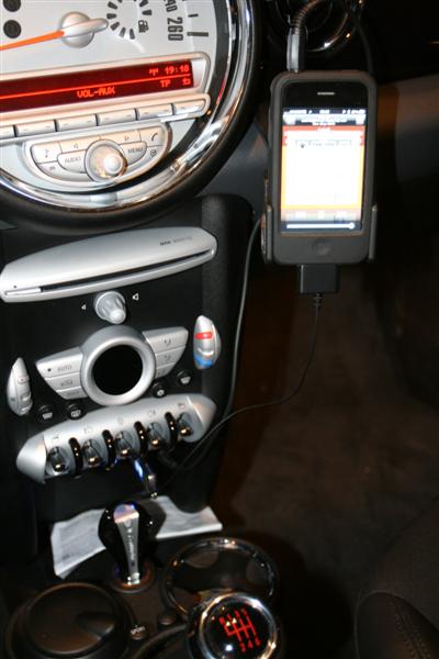

Thanks for the wonderful Photo. It's exactly what I was afraid about. All these Cables in the small Console hole............
I bought the Brodit Cradle and connect the I Phone through a 3,5mm Aux Cable which is wrapped behind the craddle and is not sooooooooo ugly.
The iphone is being charged through a simple Car Charger with an adjustable, thin cable.
The position of the phone in the cradle makes it very easy to use the Ipod Buttons of the phone.
So in short the result is OK and scrolling through the different lists is much faster using the phone. Furthermore I use an aditional USB Stick with another 16 GB of Music I'm not sure if there will be a solution from BMW/Mini for our problem in the future
I'm not sure about the sound though. I think it is a little better through the Mini USB Adapter than through the Aux in.........
