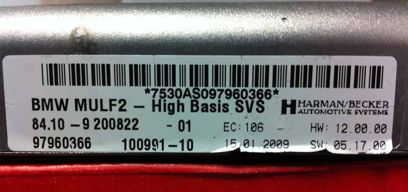

Mulf2
Thanks for the input Todney and Strobey. I received my MULF2 module today in the mail from an Oklahoma salvage company. They could not tell me if the car it came from had nav. Here are some photos.
