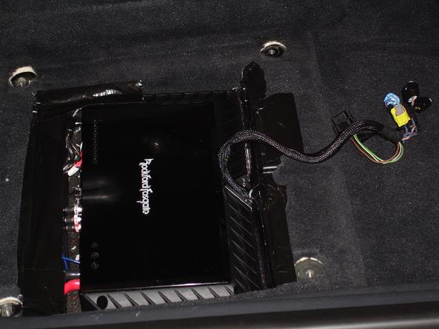

what amp is that? That's a horrid install. There's room under the front seats....roughly 16x11x2.5". Here's how the amp looked on my R53 (similar space under the seat):
The bigger issue of pulling 16-4 into the doors....it's not going to be easy. You'll have to drill out the block and add in the wire - it's not a simple as many cars where you can pull through with other wiring.
Yeah I know! That's what the installer did!
The AMP is a McIntosh 4x100W.

Your installation under the seat looks good but how do you move the cables to the CD and speakers?
I opened up the connector.
It looks possible to run two wires between the connector and the rubber that covers it against water, and move them through the original rubber cover to the door.
Drilling the connector seems a wrong way as this connector is different from the one on the first mini.
