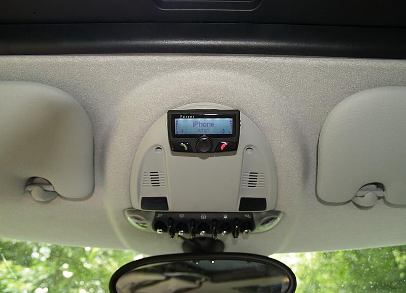

Plan on it taking about 2-3 hours to complete this project, the instructions are fairly good, however there are 29 screws you must remove to get to the back of the radio, once there its all plug and play. There is plenty of room to hide the muti-can along with the parrot box with-in the center stack. The one thing that took me awhile was figuring our how to disconnect the connectors on the center stack(push in the tab and pull down on the black lever) make sure once you reconnect them, that you test your controls for the AC along with a toggle switch or two if everything lights up your good to go...
The LCD screen is good to have if you want to keep your phone in your pocket, other than that the only time I touch the controls is using the setting features. Its fairly small and fits well on the left hand side of the steering wheel. However I spent a second afternoon cutting out my plastic overhead console and mounting it up and out of the way.
Good luck.. I love mine
