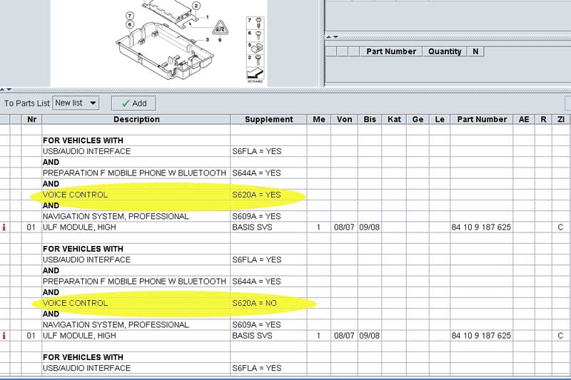

mclubman,
After looking at your signature to gain more info on what your car actually was you may not even have voice control if it was not ordered for your car.
Here is the parts diagram for a R55 clubman with NAV and Convience package. It show the car being able to be built with and with out the S620A option.
BTW in the picture for dates VON=From, BIS=To

Originally Posted by schatzy62
mclubman,
So from this would it be reasonable to assume that one could not have NAV
but retroactivly have vioce control installed? Is the S620A only the option code or is it the module?
Old Aug 28, 2008 | 08:23 AM
but retroactivly have voice control installed? Is the S620A only the option code or is it the module?
Retrofitting these options is not just a single module replacement usually so it gets very very expensive, I.E. cost prohibitive. There also are in some cases a wiring harness missing which adds to the cost even more.
I would never say "It can not be done" but there is a point at which even a dealer will usually not do the work.
S620A is the option code and I am not sure what modules it takes. There is not an actual listing in the parts software that tells you what is needed for each option code (at least that i have found yet).
mclubman,
Thanks for the pic, but I am not sure I understand it. I have voice control over the NAV, communiction (e.g., "dial number") and radio (e.g., "preset one"), among other things. I can also answer calls through bluetooth with the phone button on the steering wheel and place calls through bluetooth.
As my car was built for a September delivery, I assume it has the most recent software available, particularly if older cars delivered before mine may not have any issues.
I would call another dealer, but the next closest is KC and Chicago, not good. I could ask them to reload the software, but if the IT guys says it shouldn't work then I wonder if they will even bother to go to the trouble as its costs them money to solve a problem that may not exist (in their minds).
Is there an all knowing oracle at MINI central that addresses these questions? I spent nearly $32 grand assuming I could sync a phone or add tags at the very least. I don't love my car less as a result of this deficiency, but I would be happier if it did work.
Okay so you can control the NAV with voice commands right? And they work correctly?
As for the use of the phone thru the MFSW and bluetooth use the area totally separate from the voice control. they are two sepearate functions controled by two spearate options.

Can't create manual voice tags
I have a Clubman with Nav June 08 Build. I've paired my Iphone 3G fine and the address book loaded fine. All the phone functions work except the ability to create manual voice tags.
When I say "Save Name" the system changes the Nav Screen to the Radio Screen and asks if I want to set a preset. I also tried 'Store Name" and the same behavior occurs. Anyone have any ideas on how I can get manual voice tags to work?
TIA,

Hi Dennis,
It looks like it may be that the difference between being able to make manual voice tags and not, is having the Nav system. If you try the voice command 'Dial Name', does it do anything?
Old Sep 11, 2008 | 12:52 PM

When I say "Dial Name" it replies please speak the name. I say a name and it attempts to match it to an entry in the address book.

Okay, that seems to confirm it then- I guess all of the previous iPhone reports were either from people without the Nav system, or didn't notice that the spreadsheet was wrong about it. :/
You should be able to say "Dial [Address Book Name]" and do it all in one step, rather than "Dial Name" (Please say the name) "[Address Book Name]".
