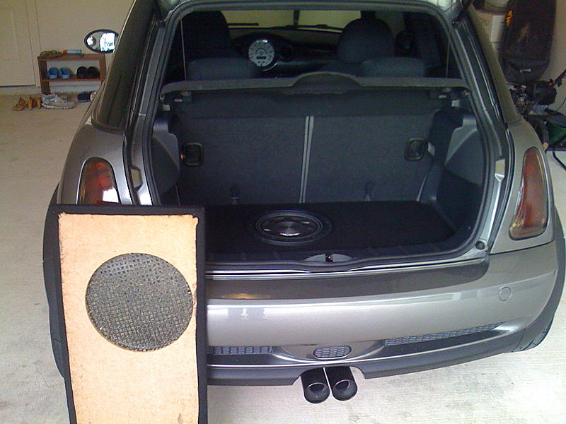

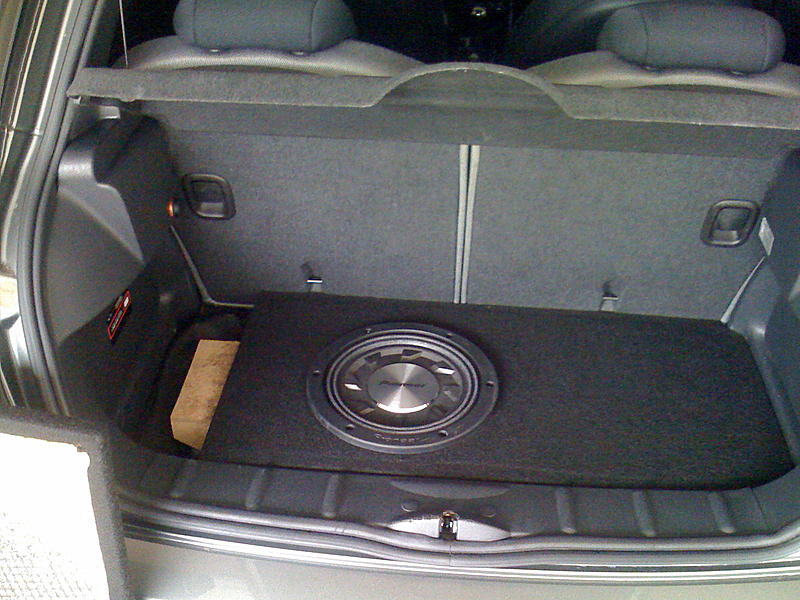

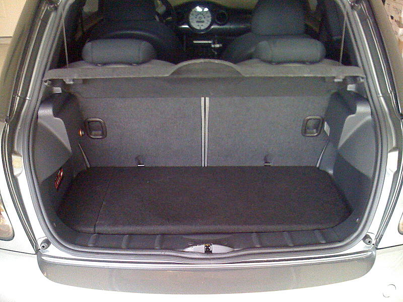

6" sub install-img_0030.jpg Click on pic.
I like this set-up, and with the seats down I have a full flat area.
The sub is 10". To the right is a 1K watt amp in an open space under the sub box panel, to the left is access to the Jack and whatever.
I've had this set-up for nearly two years. I like that it's out of sight out of mind to most onlookers.
I will match the color of the interior at some piont.
To have this set-up you'll need a "Shallow-Mount" sub so that there's air-space under the woofer and room for the box.
Fits snug so there's no movement what-so-ever, but easily removed to access the battery compartment.
Yes, with less than a 3" depth it really thumps, I have the amp dialed down to a level I can take and not disturb people in their homes.
