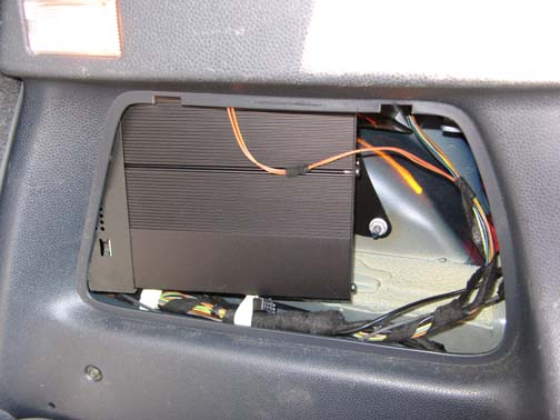

Can anyone tell if my 2006 Mini can accept a CD changer from an 05 Mini. I looked for the harness with connectors in the rear passenger side access hole and could not find any harness.
thanks to all.
FOUND THEM!

CD changer should be the same from '02-06.
You can see the connector(s) in the attached pic - it's at the bottom middle of the pic with some masking tape wrapped just behind the connector. Located in the passenger side boot cubbie. The image here includes the HK amp above the connector.

I installed a 04 used changer in my Dads 06
I was almost scared that plugs wouldn't be there or maybe differennt.
Super easy ... start to finish 10 min !
Ohhh and it works
