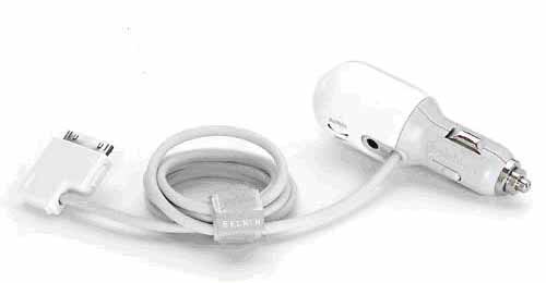

With the aux input I use a Belkin Dock Connector. It recharges the Ipod plus it does not use the earphone jack for the audio out so atenuation is not affected.
