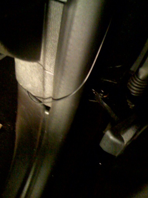

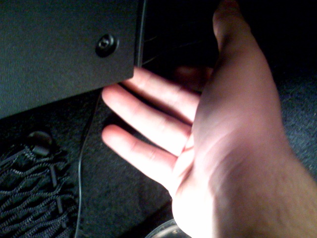

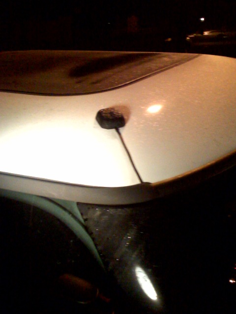

hey.. I took the little xm antenna that came with the kit, stuck it to my roof, and ran the wire down the seals of the door... then into the car.. I hid the extra in the cubby hole (if you can call it that, lol) which is accessible via the passenger side, and then velcroed (spelling?) the xm radio to the bottom of the cubby hole in the dash. I managed to find in a box somewhere about a 5 or 6 inch aux audio cable, and use that.
I attached some pictures, let me know if you need more detailed ones. I'll be glad to get them for you.
