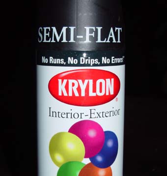

Use this it looks way better than gloss black (I tried a grille from a black car 1st) Remove grille & separate back peice steel wool & paint. If you like it remove bumper cover & mask around lower grille insert. If you don't like it the chrome ones look nice too

how well has this held up? did you clear coat it afterwards? i would think that the krylon would chip easily.

Its holding up better than I expected since I took it on the buisy freeways within a couple hours of 4 coats. No, clearcoat, that would turn it into gloss black.
