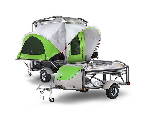

I called Minifini and talked to Russell. He said their CM tow hitch was rated up to 3500 lbs. With the help of a friend who is really capable with car installations of this type we had it on in a few hours. Be careful when removing the rear tire walls the small black pins fall out and scatter across the floor. The tow plate fits over the inside bolts perfectly. You also need to cut a small square in the narrow plastic grill and widen a section of the plastic underplate. The tow hitch is rock solid.
I researched all types of pup trailers and teardrops that were light and could easily towed by the CM. The Livinlite Quicksilver 6.0 is a good choice but because I haul lots of sports equipment (bikes and kayaks) I needed something that could haul these and provide the pup tent for camping.
I chose the Sylvansport Go Trailer and found it tows like it's not there. It's only 840 lbs. I thought it was expensive ($7999) but once I saw the craftmanship and heavy duty aluminum frame I was sold. I even became one of their "Go Getter" reps and can get you a small discount.
