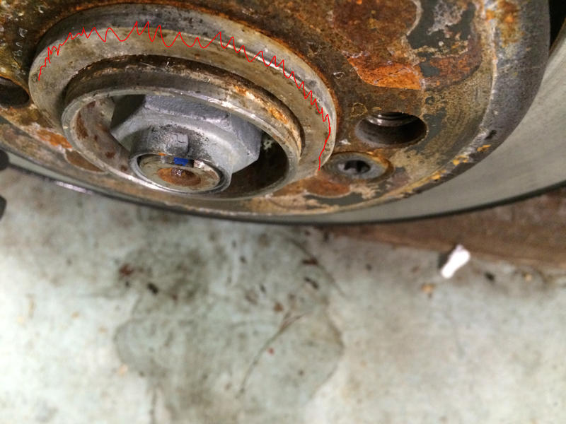

My Bad I think there may be a spacer on my wheels.. not sure as this is the first cooper I've owned and have only had it 1 month ...I had taken a photo of my rotor hat after I could not get the wheel on.... and after checking the internet none have what my wheel has on it...I will include a pic with the portion in pic in red .....this ring is the reason the wheels won't fit. Does anybody know what it is and can it just be removed?
Unfortunately It is raining right now (no Garage) and I can't check it till tomorrow but if anyone knows what this ring is give me a shout.
I have no Idea ...all I know is I ordered a set of winter tires from tirerack and the wheels I got were focals and they sent a center ring to go in the wheel before installing they fit perfect I had no reason to think there was anything odd...so I'm still not sure

Originally Posted by americo11
My Bad I think there may be a spacer on my wheels.. not sure as this is the first cooper I've owned and have only had it 1 month ...I had taken a photo of my rotor hat after I could not get the wheel on.... and after checking the internet none have what my wheel has on it...I will include a pic with the portion in pic in red .....this ring is the reason the wheels won't fit. Does anybody know what it is and can it just be removed? Unfortunately It is raining right now (no Garage) and I can't check it till tomorrow but if anyone knows what this ring is give me a shout. I have no Idea ...all I know is I ordered a set of winter tires from tirerack and the wheels I got were focals and they sent a center ring to go in the wheel before installing they fit perfect I had no reason to think there was anything odd...so I'm still not sure
Looks like the centering ring got left on the hub. Just pry it off with a couple of levers/screwdrivers.

Really thats all it is ...I feel like a complete idiot....I didn't realize it was abnormal until I started looking at other hubs...Thanks Spiney....well I sure am glad I can put those rims on now I thought I was going to have to sell them.

The only thing that is still odd is the winter tire set up I purchased had center rings that they sent and I put on the rim before installing and this other ring was on the hub and it didn't interfere with the winter ones, but they were focal rims and not mini specific so maybe the bore in the wheel was larger and that's why they fit over it? I'll try it again tomorrow .
Thanks Again Spiney .....big sigh of relief!

+1 " Looks like the centering ring got left on the hub. Just pry it off with a couple of levers/screwdrivers."
Yea, these MINI wheels will fit all Gen 1 and Gen 2 MINI with 4x100 pattern and 56.1 CB ( which is most everything , except Countryman / Paceman and the New F56 MINIs+).
Its ok , looks like they aftermarket hubcentric ring was just stuck on there.
One other tip, I swap my winter to summer and back again after the season.
Wire brush the wheel hub and the face of the rotor where it makes contact then smear a very thin layer of anti seize, this will help fight the rust and make sure the wheels match up.
I am glad you go it figured out.
