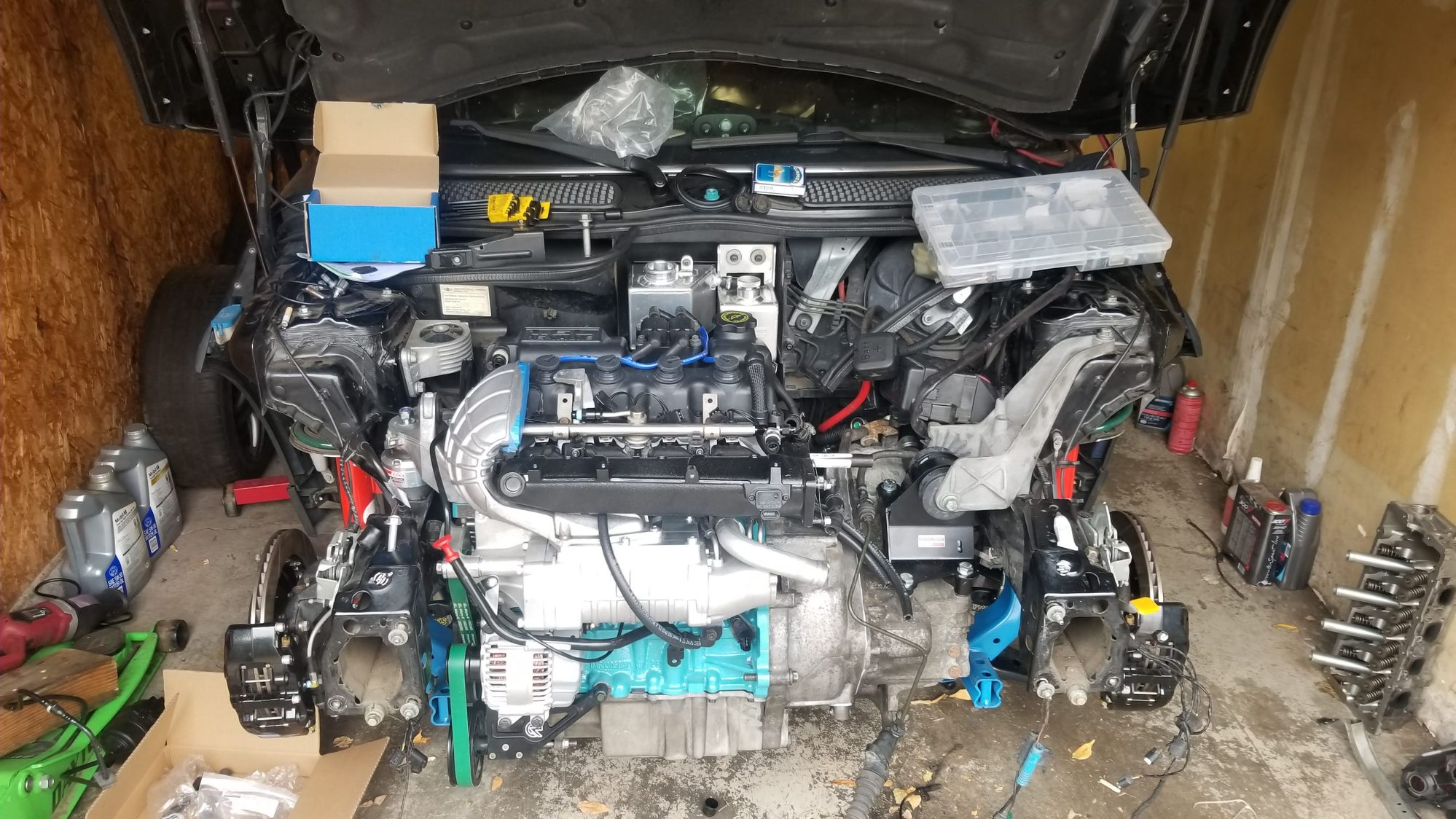

Mahle pistons, Molnar rods.
I guess this is mopar blue?
Assembled.

big bore and stroked crank? or stock dimensions on bottom end?
going e85 or pump?
Old Dec 17, 2020 | 11:41 AM
MonzMini's Avatar
MonzMini
Joined: Aug 2016
Posts: 113
Likes: 16
From: Mountains
going e85 or pump?
77.5mm bore, stock crank, flex fuel.
Edit: Flex fuel so I can run whatever.

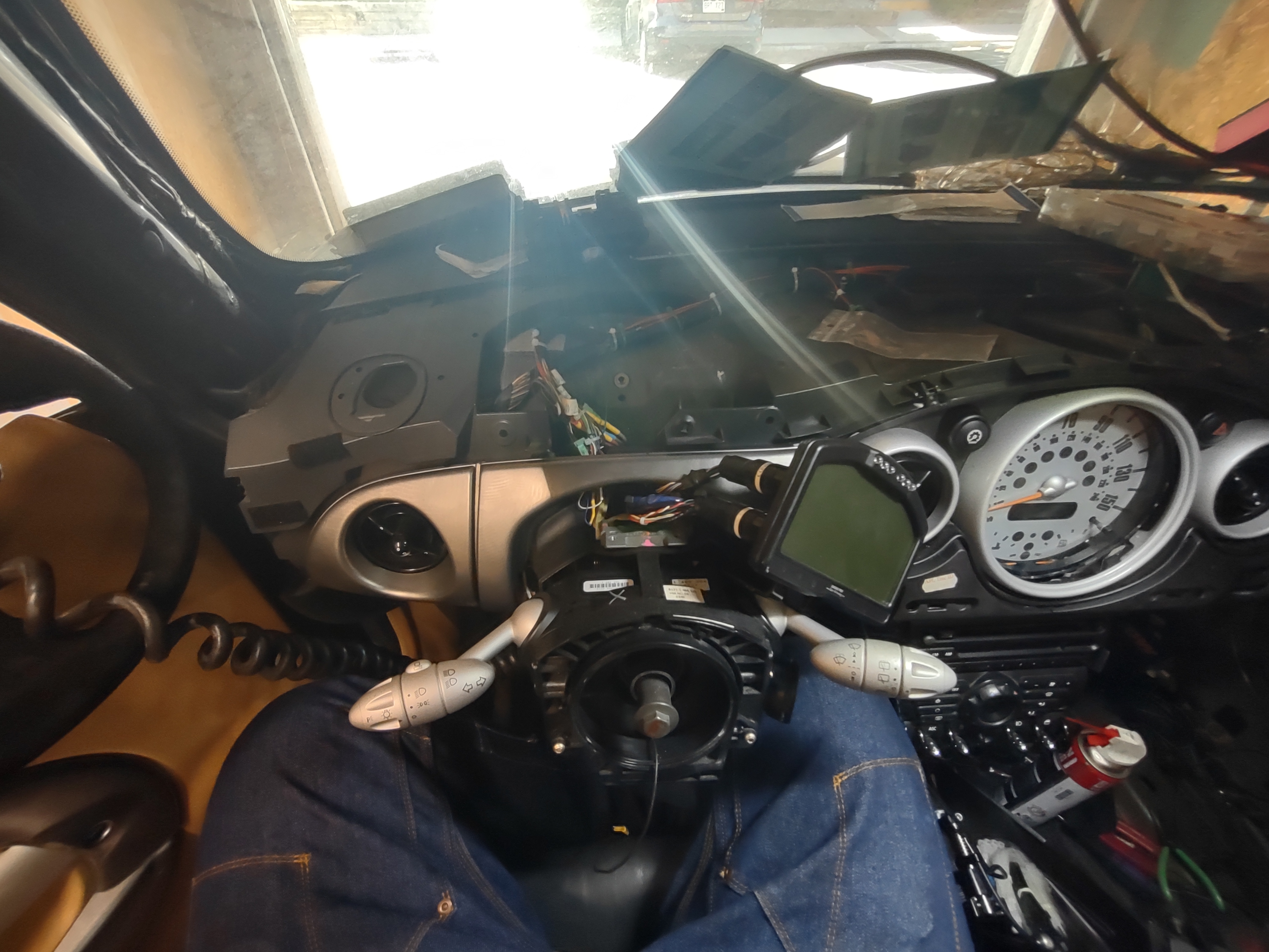

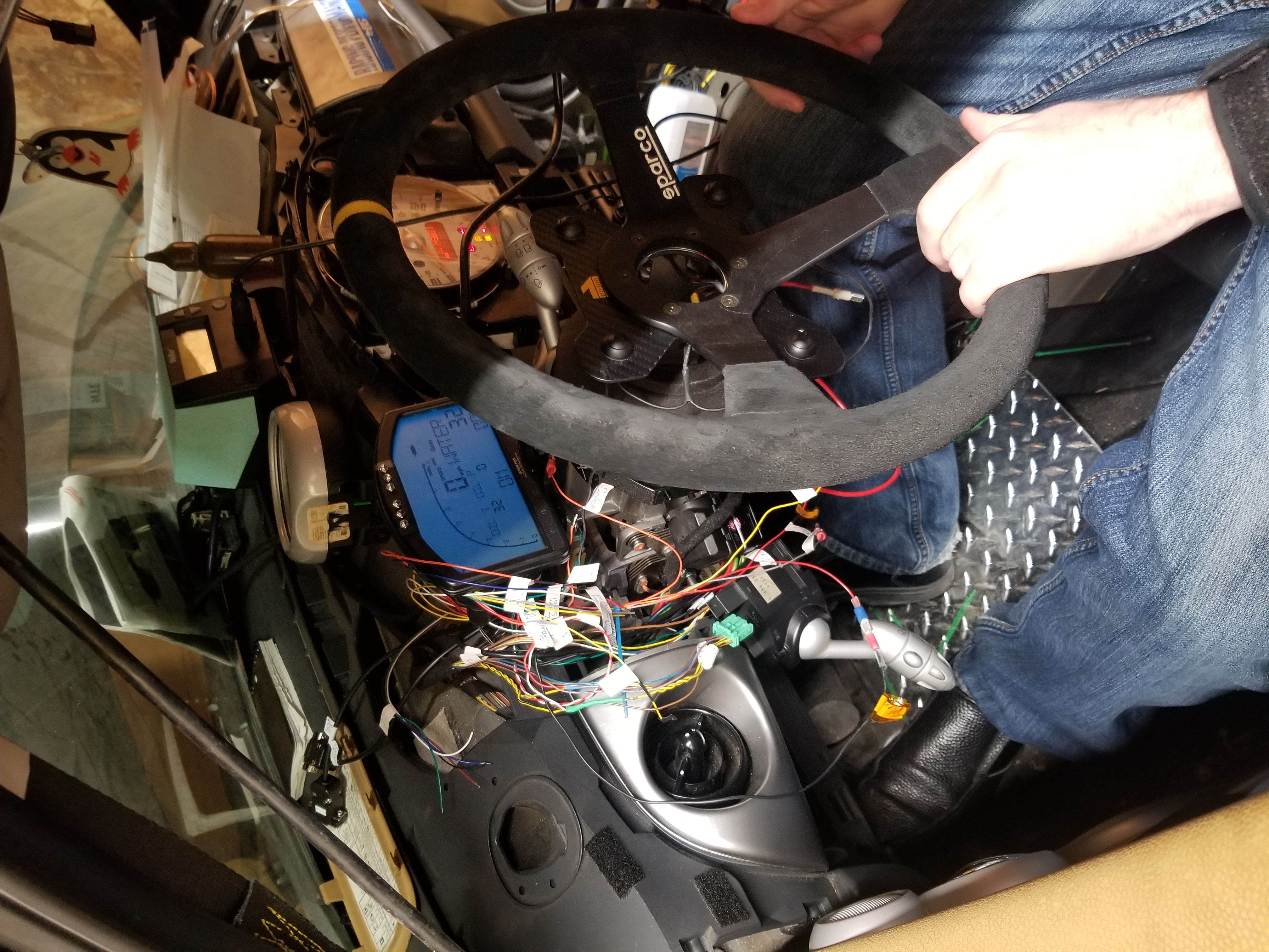

Sparco wheel and momo cf button plate.
Mock-up The cockpit, is starting to take form. P.S. I'm replacing both seats, with bucket seats.
Oooooohh, I like! Wheel fits damn well, for "eye balling" the size, at the shop.
Drilling through carbon fiber feels like a form of blasphemy... But, it came out nice.
Installed. Time to figure out wire routing.

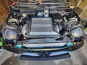

Been awhile. Life went sideways for a bit. But here's an update, for you guys.
Attached Thumbnails R53 TVS900 Full Build-img_20220608_084728271.jpg   R53 TVS900 Full Build-20210210_233659.jpg   R53 TVS900 Full Build-img_20220504_190730050.jpg   R53 TVS900 Full Build-img_20220608_125251184.jpg   R53 TVS900 Full Build-img_20220608_155707672_hdr.jpg
R53 TVS900 Full Build-img_20220608_183104303.jpg   R53 TVS900 Full Build-img_20220608_213621360_hdr-2.jpg
