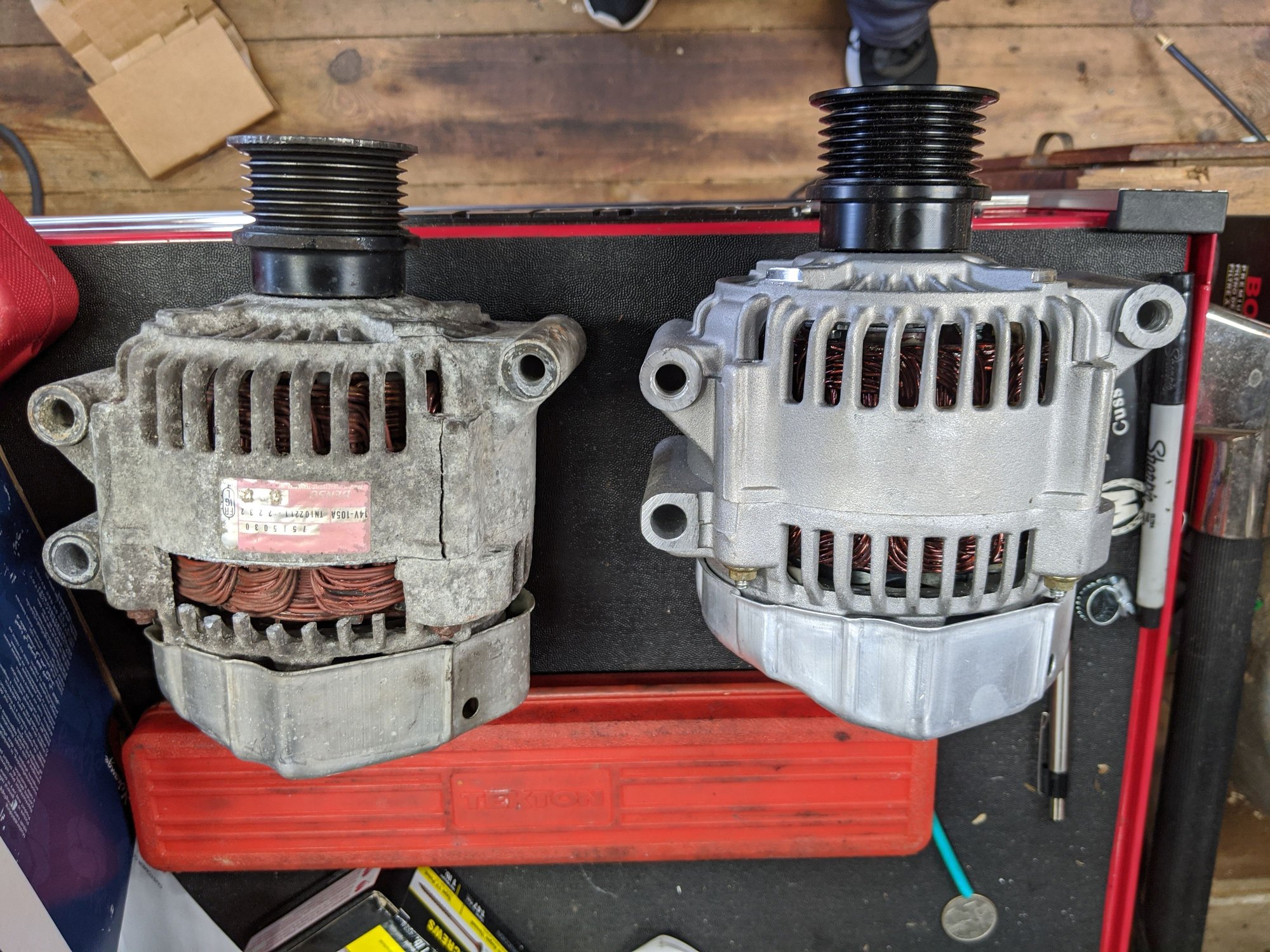

Hello Everyone. Hope everyone is doing well considering whats been happening. I ended up having a lot more free time, so was able to finish my GP project! Ran into a couple more issues, mostly around rusty and worn out suspension, but i ended up getting the car running and i've put about 500 miles on it over the past couple weeks. I got the AC charged, and it is really cold, even in the hot weather. If anyone has issues with weaker AC, change the evaporator as rock chips had destroyed most of the fins on the old one.
Also changed out the fan resistor, put in a RMW shorty header
Ended up replacing the front suspension
Found the top hat was completely cracked around where it had been attached.
Replaced it all while it was apart
New bump stop - the old one had completely failed
reused the spring
All installed on the car
Had a custom Whalen shifter **** and brake handle made
Feels great in the hand with the Cravenspeed short shifter
Decided to put a new evaporator and compressor in the car as the AC wasn't strong before.
My other Mini had a failed alternator so i threw in a new alternator on this and put the old one in my other mini
Replaced the hand brake lines. They were completetly siezed. It's nice to have a hand brake again.
Put in some new speakers while the car was all apart
New bushings, Inner and outer ball joints etc..
Put in a RMW shorty header
It's done! So nice to be able to take it for a spin
I got the front suspension worked out, but they couldnt change the rear. Any thoughts on whats wrong?
